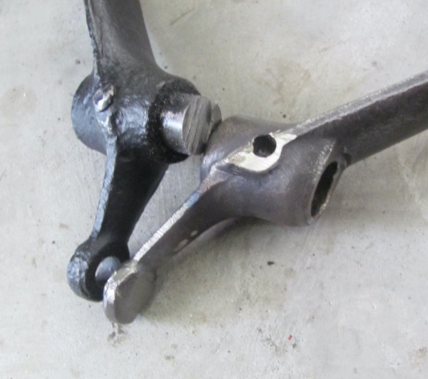

Early pedal without starter and Bendix has a straight arm, you will need to try to bend, but it will remain too short. The best, replace with later clutch pedal.

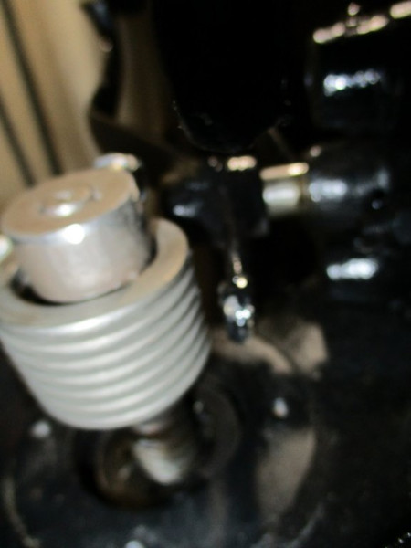

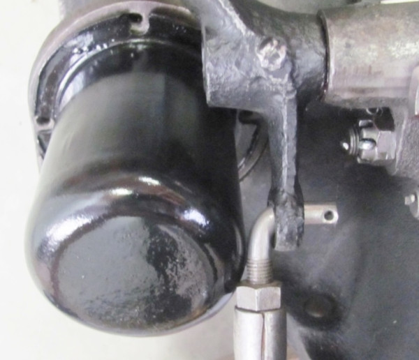

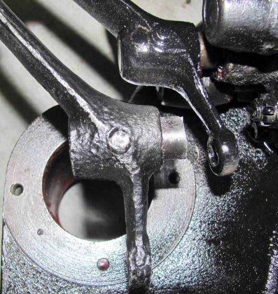

Dan, that one photo is definitely worth a thousand words!
I compared my space with another early starter transmission cover and a non-starter transmission cover and everything looked the same.
Evidently, if you bought a 1917 or later Non-electric Model T, you got a transmission cover cast for the starter mounting with blank off plates and a different clutch pedal.
I had to change the magneto coil ring as it was a double that matched the early flywheel.
The arm that engages the high speed clutch also sticks out too far and would have to be heated cherry red and bent in about half an inch to line up with the proper connecting link.
I either need to find a correct transmission cover (now that I know what my problem is) or change both of those items, if I can find them.
