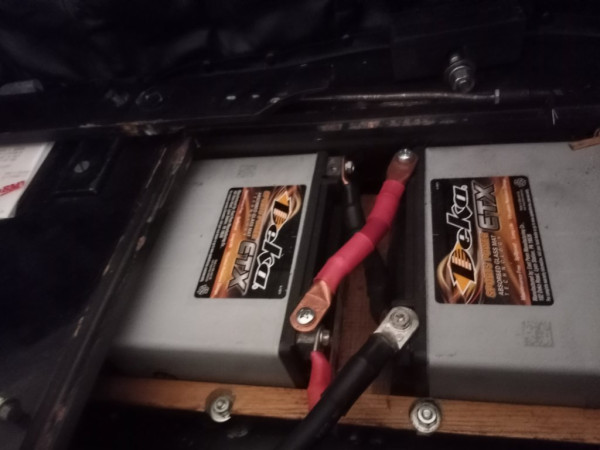

FWIW here's the battery arrangement in my '11 Torpedo. And yeh there isn't crap for room to store anything under the seat! Thankfully mine came with a real nice wood tool box behind the gas tank.
