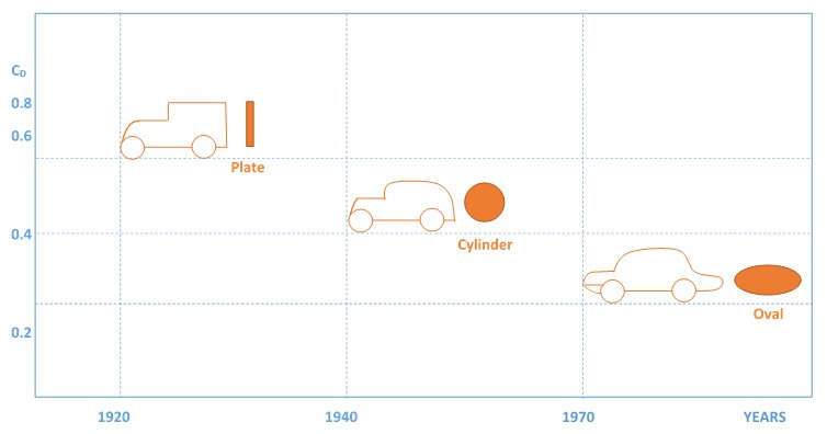

As you get above 30 to 35 MPH on level ground, aerodynamic drag has more effect on speed capability than weight. A 17 tudor may not have a whole lot more drag, if any more, than a 27 touring with the top up or down. A 27 touring car with 4 adults aboard will likely out-weigh a 27 tudor with a driver only.

If you want a coupe/sedan to go faster redesign the body to eliminate the drag. Reduce the frontal area.
Found this on line:
https://www.academia.edu/6471009/CFD_An ... rd_Model_T
https://www.academia.edu/17643611/The_T ... rodynamics

To get a good idea of what can be done to a T to reduce aero drag and weight on a road-legal T, look at speedsters.
The ultimate low drag T would probably be a drop tank bodied speedster.
About all you can do with a stock bodied T is to avoid adding any unneccesary weight or any exterior mounted accessories that would likley add aero drag, such as dual mirrors, bumpers, outside mounted spare on a coupe, spot lights, flags, raccoon tails, running board boxes, etc.
A T sedan's aero drag may not be as much as that of a coupe or touring car, especially an early touring.
The sedans carry a 250 to 300 lb weight penalty over the open cars, which would have little effect on level road speed. In most hilly country, you go down as many hills as you go up, so weight would have little effect on average speeds, traffic permitting, assuming no long climbs.
A Model A will maintain 45 MPH or better under most open road conditions. Compare specs and comformation of a Stock Model A sedan with a stock Model T sedan.
The Model A has at least twice the power and a higher RPM limit, along with a somewhat smoother profile. The Model A is about 30% heavier.
