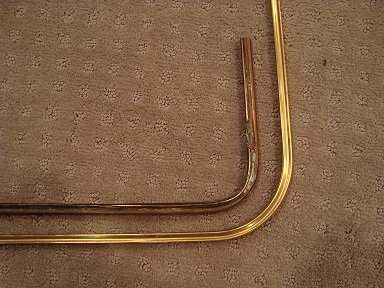

I bought the brass windshield channel kit for my 1910 T, but the corner bends that are on the channels are too wide. I have a small piece of the original channel corner and it is a tighter curve. How do you go about adjusting the bend in the curve so it's tighter? Anyone with experience on the subject kindly advise me. The kit isn't cheap but required, as far as I'm concerned, when you're working on an early T and I don't want to mess it up. Thanks!

Thanks, Richard, that's a good idea. How thick should the masonite be? Also, here is a picture of what the difference looks like. I'll email you for the information you have on the frames, thanks!

Bill, Richard's tip about the masonite is spot on. It makes a former which will prevent the channel from collapsing inwards while setting the shape of the curve at the same time. I would go one step further and make a tool to help keep the channel from spreading while reshaping the bend. Timber is your friend, as it is softer on the brass. Cut a 1/2" wide strip from material the same thickness as the outside of the channel. Fix a strip either side of this piece with depth of the channel as your guide. This U shaped tool can be used in conjunction with the masonite former to keep the channel from distorting.
I don't know about not using heat. I would be tempted to anneal the bend before starting. Others may disagree. Certainly do not use heat while attempting the re-shaping.
