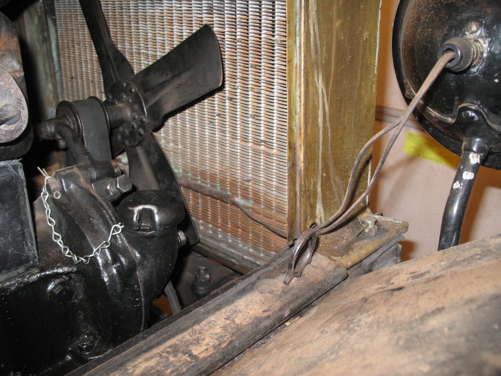

Yes, it will, but it will have the little acetylene pipe for the gas lights which you will not use.
I use the pipe as a tunnel for the wire between the headlights. That allows the wire no chance of meeting the fan.
- Posts: 4679
Re: Radiator question . .
Steve that’s a good idea to keep your oil filler cap from bouncing out. I think Henry would approve!

...that’s a good idea to keep your oil filler cap from bouncing out.
I'm not going to lose another one.

Two years ago I forgot to put the cap back on. Jim Riedy was behind me on a tour and fortunately he saw it and retrieved it for me. It was at least 30 miles into the tour when it fell from the car. I plan to tether it similar to that in the picture.
