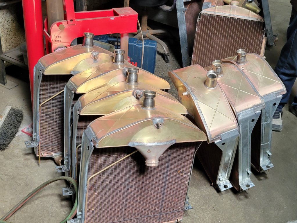

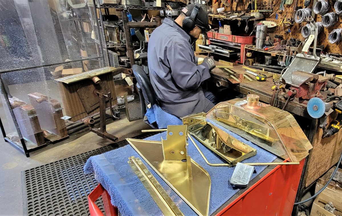

As a side note, I had the opportunity to visit and tour the Brassworks facility last October and see their craftsmen at work.
Keith
I'm with Scott. I want my radiator to look correct for a stock looking car. If I had a speedster with all kinds of modifications that needed cooling that is "better" than a flat tube, and did not care about the appearance, I suppose the "extreme" radiator would be a option. Maybe on Poncho Villa's La Cucaracha!
