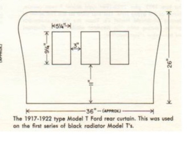

Just wondering how high above the rear panel top beading for a touring car is the bottom of the three rear curtain windows?
Mine is about 8 1/2 inches.
I imagine there is some difference as production lines were rushed.
Regards,
Steve Boothroyd

Check and double check! The worst curtains I see all the time are the 23-24 lights. It pays do do some research on this question before laying out your lights. That is what Ford called them.
