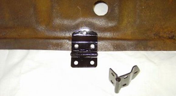

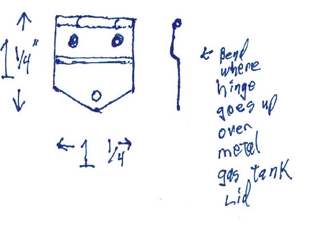

These pics were on the forum on an earlier thread about gas lid hinges.
