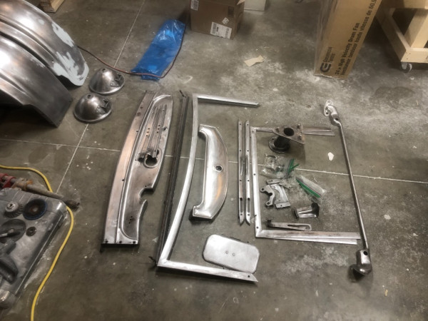

Looking for help trying to decide on trim colours for 27 coupe.
I have searched the forum but seem to get different opinions on what is original. I was planning to paint the dash, windshield frame, and windshield side trim/swing arm bracket body color, but the lower steering bracket black. The window trim pieces black.
I like the look of the windshield frame exterior body color but would kind of rather have the interior part of the frame black.
Curious what was original and if anyone has photos of a similar scheme?

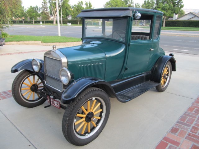

Period picture of a new green 1927 Model T coupe with its’ windshield frame painted the same color as the body…

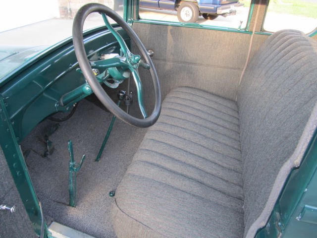

Just a few things to denote: my all original 27 has a black steering wheel and brake handle.

Nothing associated with the steering column is supposed to be green, or any color other than black. I seriously doubt that any interior window trim was any color other than black as well. The parking brake lever also belongs black.

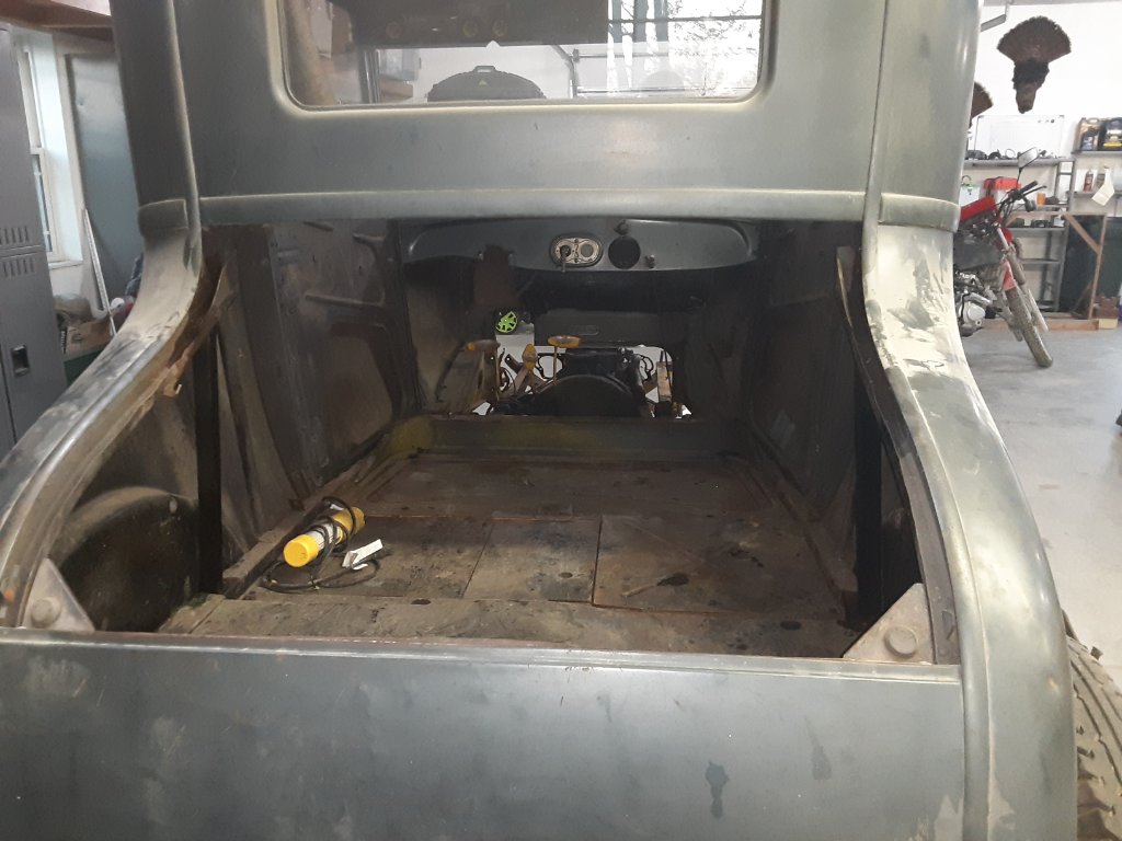

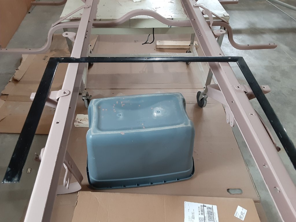

Bruce, considering the original condition of your interior, did you have any photos of the dash and windshield areas?

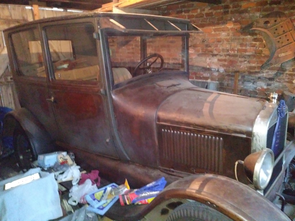

Here is a picture of my unrestored 1927 Tudor for reference to windshield frame color.

John, not sure I can tell from your photo, what color is your tudoor windshield frame?

You can see what is left of the green paint on the lower body and upper door and windshield post. The windshield frame is clearly not the same color. I believe this car has never been repainted. I don't know if other cars had body color matching windshield frames, but this one is black.

BTW, the interior trim around the Windows are black also and the dash is green.

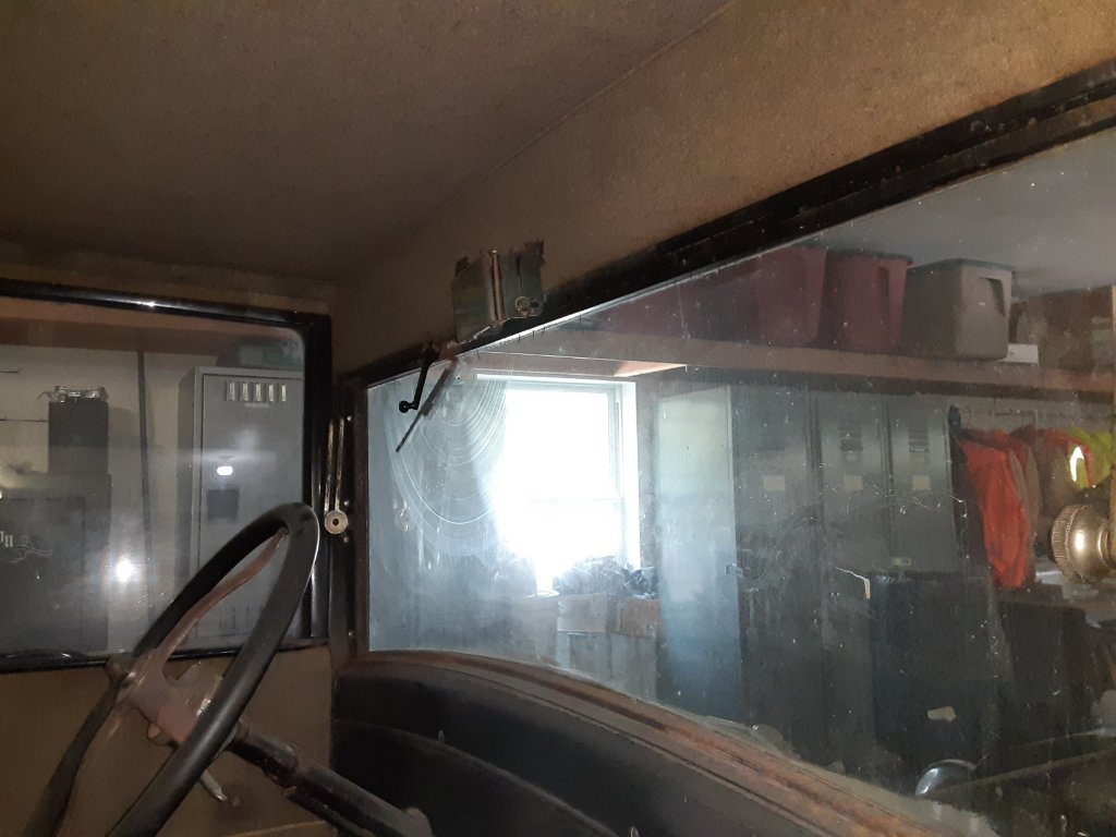

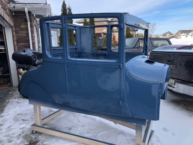

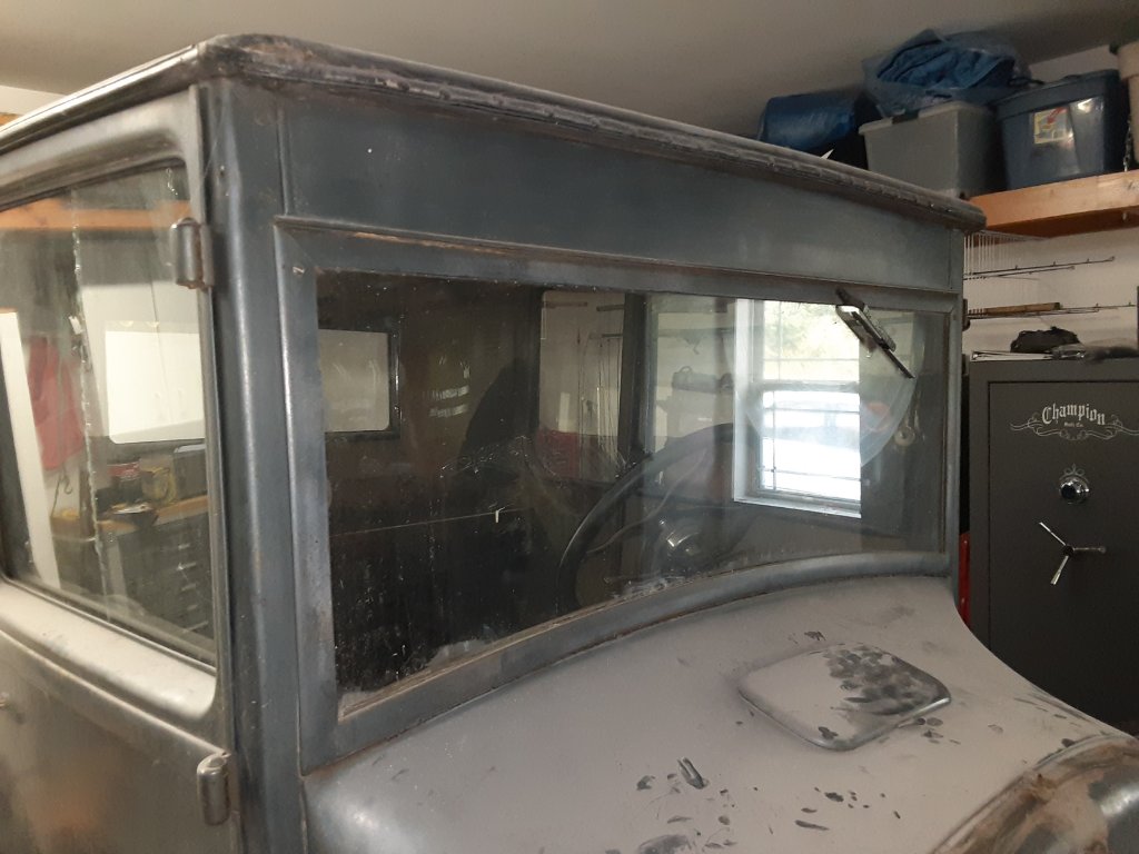

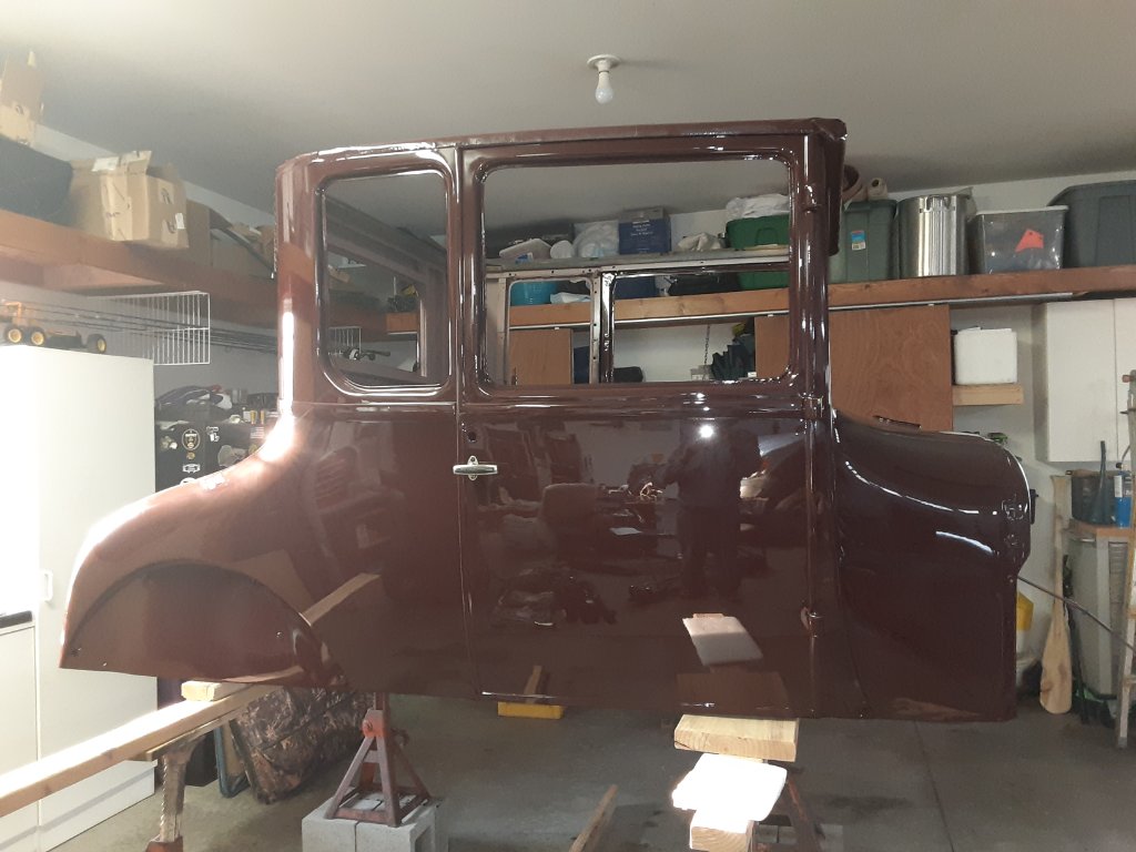

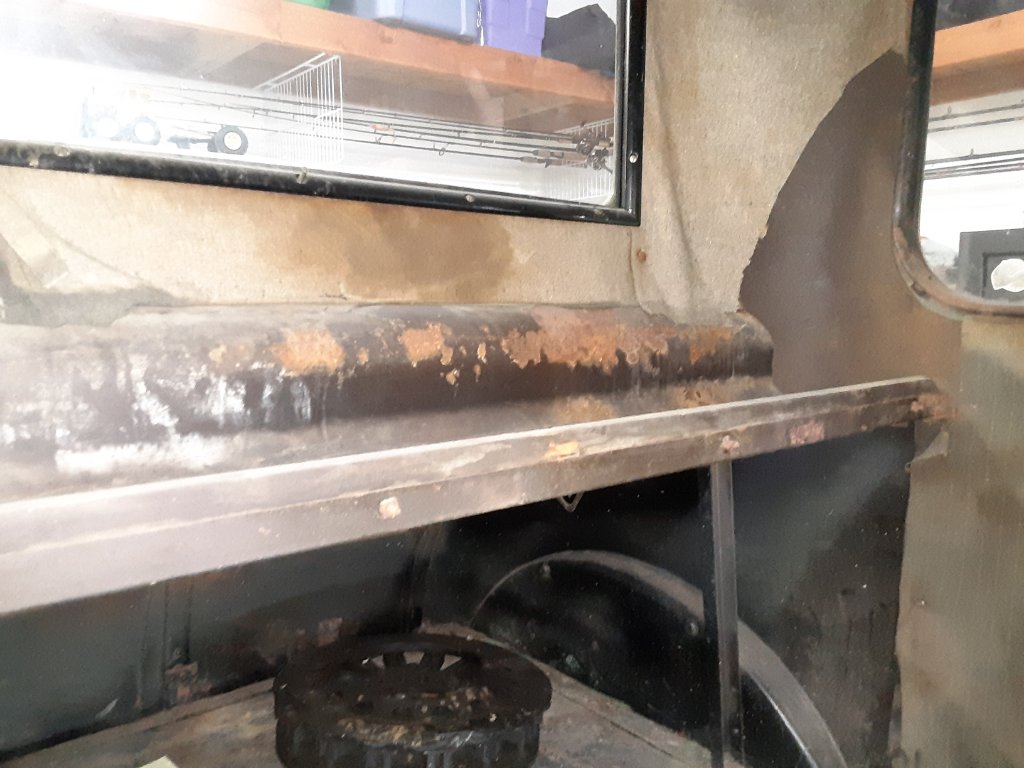

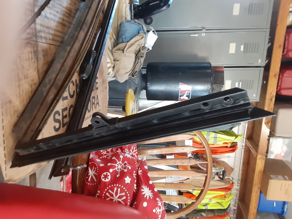

Brent, Here are several photos that you asked for. I am not sure what color the windshield frame was originally. I think it was black. The second photo shows it same as body color, but based on the third and fourth, it appears the the back side was black. I assume we painted the front side the same as the body during the repaint.
The coupe was painted in 1954 when I was a junior in high school. Unfortunately, I do not remember much about the repaint. A young man moved from California to my home in North Dakota. He had been painting cars in California so I had him paint it. I do remember the body paint was lacquer. My 11-27-21 11:12pm post, generated discussions about my coupe's original color.
It is now maroon with the windshield frame black and interior window trim black!

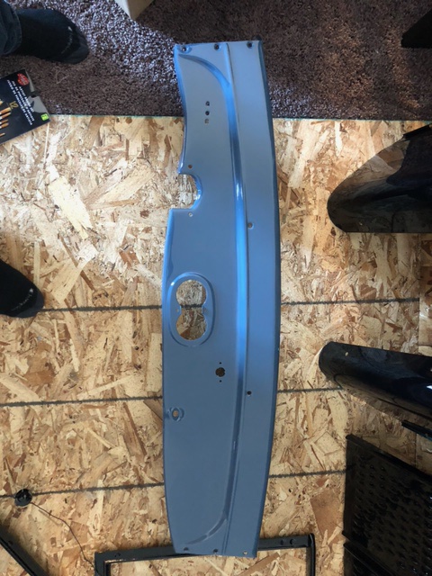

Here’s mine!
Also have a question for you experts out there what are the three holes for on the left side of the dash (see photo) the two outside are square and the middle is round.
Here’s mine!

Those 3 holes don't belong there. Somebody added them for an accessory of some sort.
