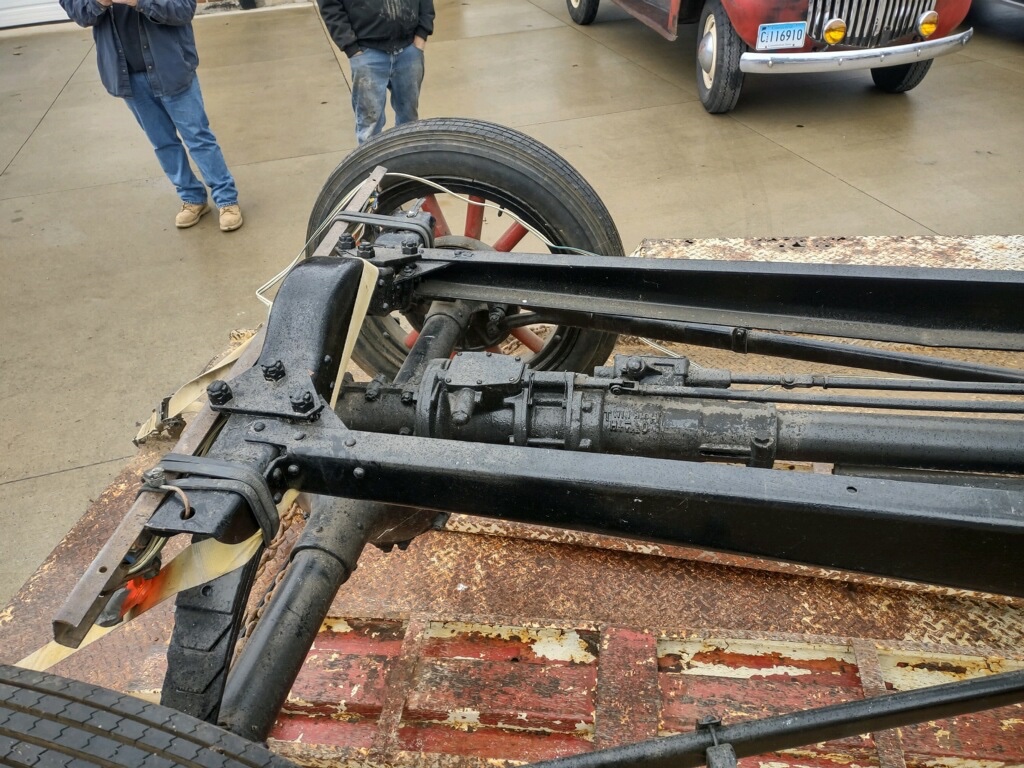

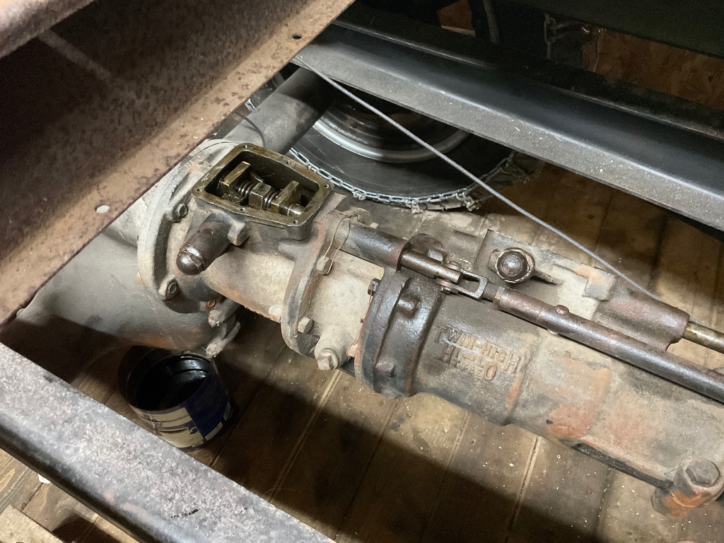

I just bought another TT project which comes with this Twin-High Hi-Lo rear mounted transmission. I am anxious to take delivery to examine it closely in person. In all the forum archives, there are only a few posts about this transmission. I am wondering if any new info has surfaced or if anyone has any experience with these units.

I have never seen a drive line/axle Twin High transmission. I have two engine mount Twin High transmissions. From what I have seen and have been told, the Twin High transmissions are built like a tank. It appears they were designed and built by aircraft engineers. The biggest problem seems to be the bearings. If you need to replace them, they are very expensive and may be hard to find. Otherwise, with proper lubrication and regular maintenance they will last forever.
I'm looking forward to your reports on what it looks like when you get your hands on it.

I have a Twin-High Hi-Lo in my '26 TT and thoroughly enjoy the operation and performance of this transmission. The Twin-High Hi-Lo transmission allows my TT to stay up with T's on road tours. The engineered design of the rear axle mounting of the Twin-High Hi-Lo transmission allows the Ford drive line to operate at its designed speed. Auxiliary transmissions that mount to the Ford transmission increase the drive shaft speed (rpm's). The TT drive shaft is quite stout/heavy, as a result, if there is an imbalance or bend in the driveshaft, this will result in pronounced driveline vibration. Further, you can "shift on the fly" easily and the weight of the Twin-High Hi-Lo is placed on the rear axle assembly.

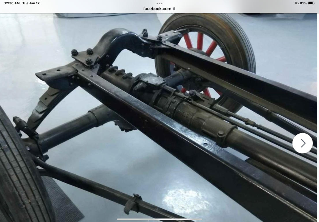

Thanks guys very interesting. Dallas I’ve heard nothing but good things about the Chicago auxiliary transmission with the exception of it being heavy. When I attended the hundred year anniversary in Richmond, there was a cream color TT with a flat bed, I believe the owner was Mr. Cordes from Texas and they drove it from there to Richmond, Indiana.! What I was told it ran at speeds in the 50’s. I do know it had multiple auxiliary transmissions & I think one that was butted up to the rear axle. I found all that info to be fascinating but did not hear it from the actual owner. Now I may be lying about this next part but I think it also had ac in the cab which ran off a very small compressor. The engine was a model T engine but I never found time to get back to talk with the owner because my youngest daughter was about to go flying in a Curtis Wright biplane that was part of the event we were at. Thanks again I’ll be following this thread with continued interest. Best John

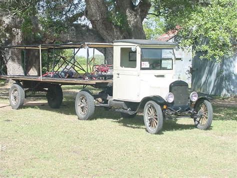

If I get really brave, I have a Rocky Mountian 6 speed that goes on the rear axle much like Mikes Twin High-lo. It came with the chassis and Dave Stroud had planned on installing it when he had the chassis. I need to install the Rocky Mtn rear brakes before that.

Thank you for the info and pic! Ive had an ember glowing about building a tractor/trailer rig for a while now. Your pic just fanned that fire. This pic has been my inspiration.

Well now you have another chassis ? I see a big rig in your future.

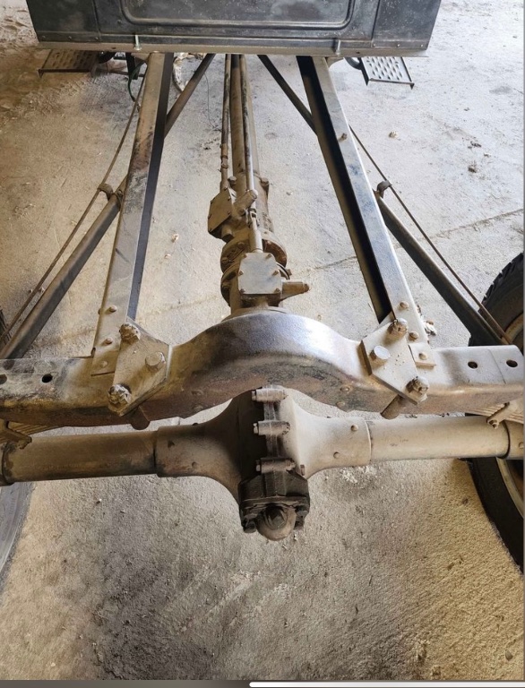

Well, I am now in a very small subset of TT owners…..that being TWIN-HIGH HI-LO TT twins! I found another Unicorn. I just purchased another TT truck that to my astonishment sports yet another TWIN-HIGH HI-LO transmission. The truck appears to be a time capsule. Ill know in a couple of weeks when I pick it up. Im so excited that I can hardly stand myself.

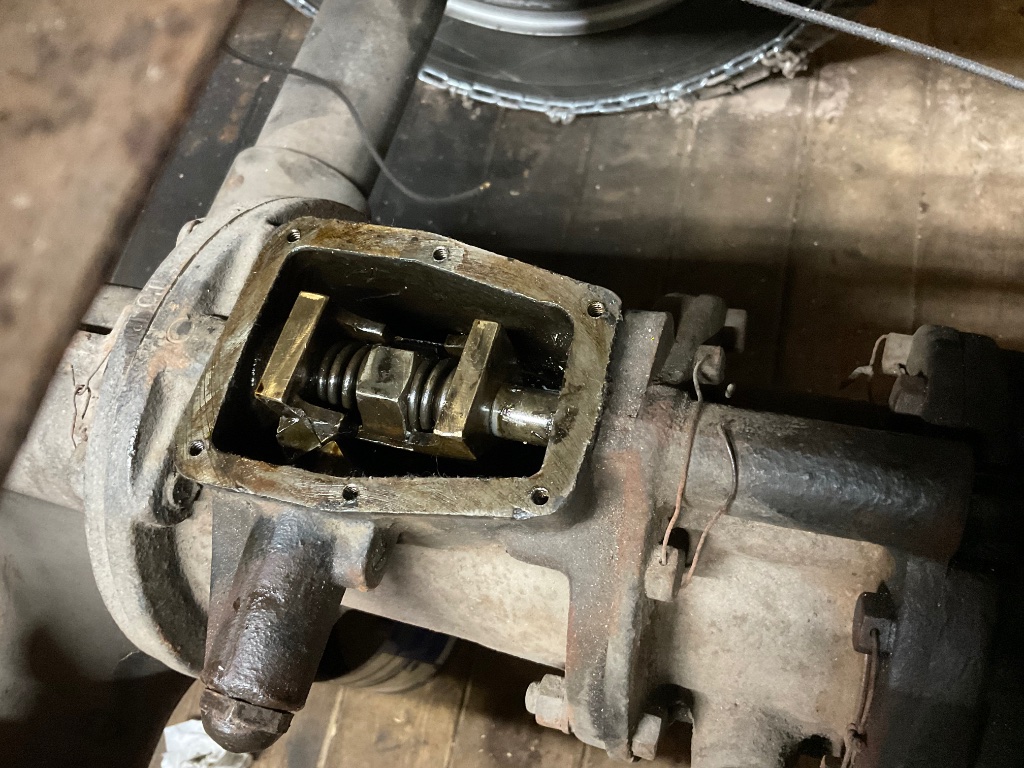

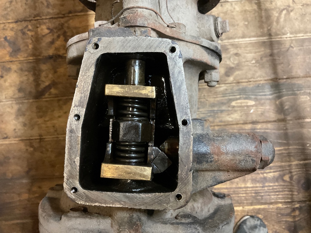

I pulled the cover off the Time Machines’s Twin-High shift detent and got a nice surprise, clean, no rust and sharp teeth faces! It looks to be in excellent internal condition and, I hope, low use. Yee-haw!

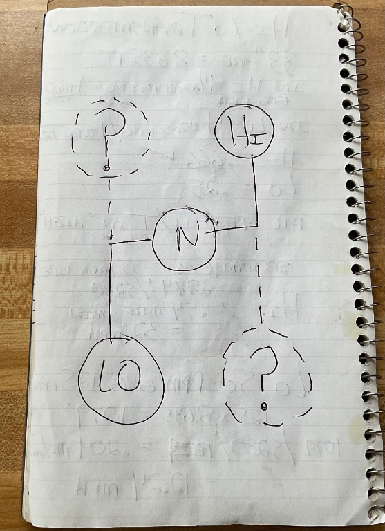

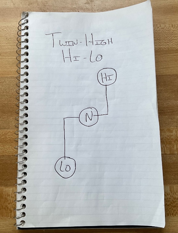

Ive now been on many short drives tying to figure out the shift pattern for the Twin-High. Repeated frustration finally made me tackle it in the garage. Figuring out the shift pattern sounds like a really easy thing to do….right? High and low, how hard can that be? Well when detent positions are so far off that they allowed cross- shifting, it was not something I wanted to experiment with. I jacked up a rear tire and pulled the plugs on the engine to start recording tire vs. crank revolutions in an attempt to start somewhere. Since I am alone, everything had to be done with the TT in std. high. With nearly two hours of frustration getting nowhere and a sore crank arm, it finally dawned on me that it could NEVER have worked as intended in the current configuration. The adjustment yokes on the shift rods are there for a reason……duh! I adjusted both yokes to put the heavily loaded spring detents in the proper locations for the neutral lockout on the shift gate to be functional. Resolution was fairly quick after this. I had wrongly made the assumption that it must have worked as is. I have attached a sketch showing the intended shift pattern if it helps anyone out. I am very anxious to get out on some dry level roads and test everything out.

To clarify….with the yokes not adjusted correctly, the shift gate allowed this configuration and is what led to my confusion and reluctance to “trust” any setting.

Your first sketch is correct, which the exception the N is DIRECT DRIVE (NOT NEUTRAL,UNDER or OVERDRIVE).

Do you know if the detent springs on the Hi-Lo are original? All (4) of my springs appear identical on both my transmissions. The compression springs seem excessive to me in regard to their intended purpose. At the height of its travel and just before the detent snaps down, the spring is very nearly solid height. This is bad spring design and drastically shortens their life(30 year diemaker speaking here). Does your Hi-Lo shift easily? Its a bit of a push or pull to activate mine….more than I feel should be normal. I could understand the excessive pressure if it were helping to hold a helical pitch gear in place under load, but its not. I believe the internal gears and associated splines are all straight cut as I see no indication of anything rotating during the shift.

I believe the Twin-High Hi-Lo shifts correct for that period --- with that said, when shifting from Under to Direct it shifts a tad harder. I have over 13,000 miles on my TT since restoration. I've disassembled and reassembled the transmission and saw no abnormalities.
Next few days, I'll take photos of transmission with the top cover removed and send to you, so you can see the fork and springs.
