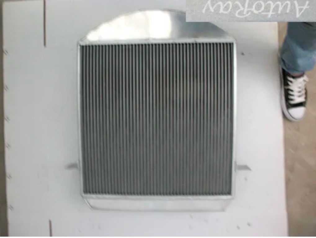

Odd how a radiator for my modern can be had on ebay for about 120 bucks,Aluminum. Why isn't someone sending a design to someone and try having the 1's for drivers cars made out of aluminum?
I know there would be no trophys for them but hey if it keeps the T cool,and the wallet from blowing away in the wind why not try?

Well my purchase history doesn't go back far enough to find the link on ebay but the aluminum radiator i installed in my 91 F150 is all aluminum. NO plastic at all.appears to be tig welded thru and thru. and it was like 140 bucks?

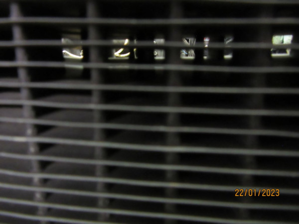

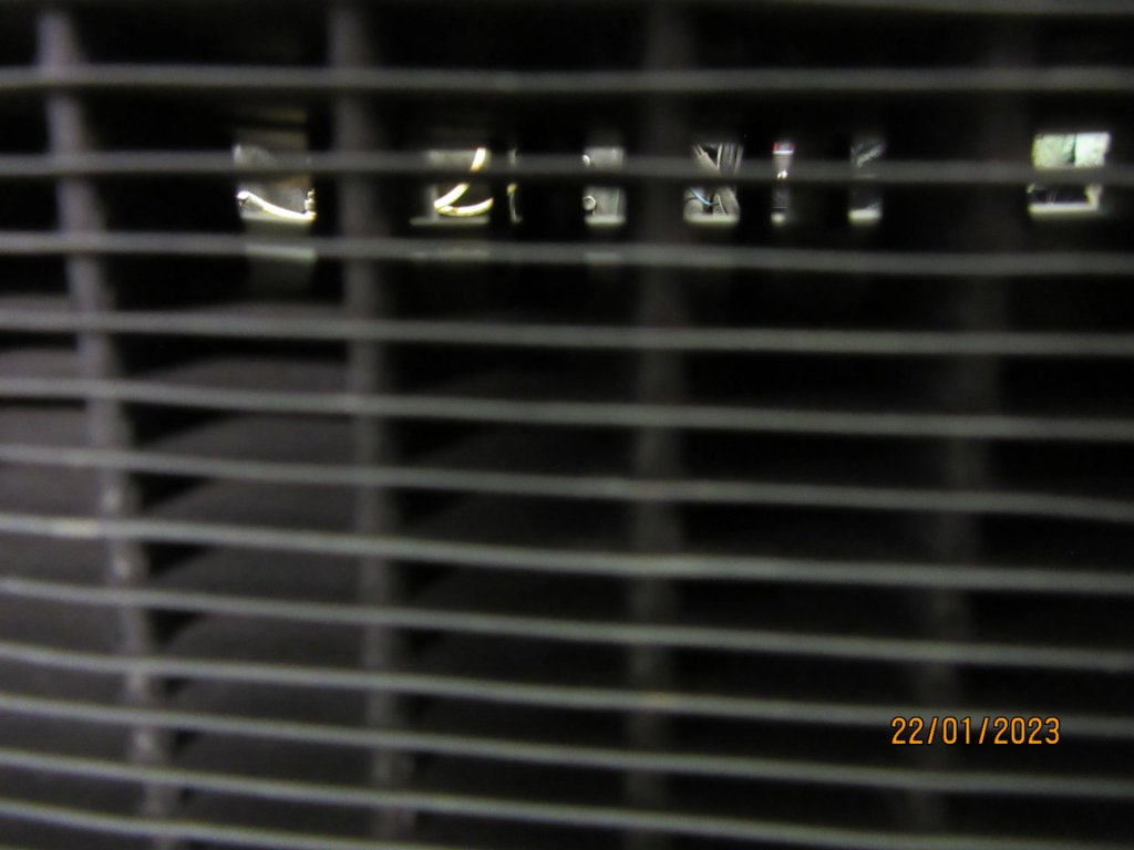

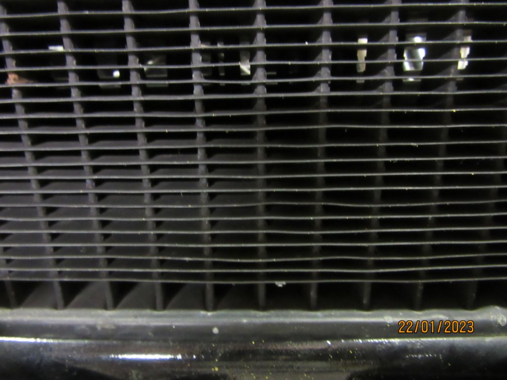

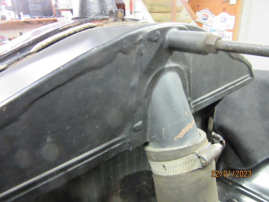

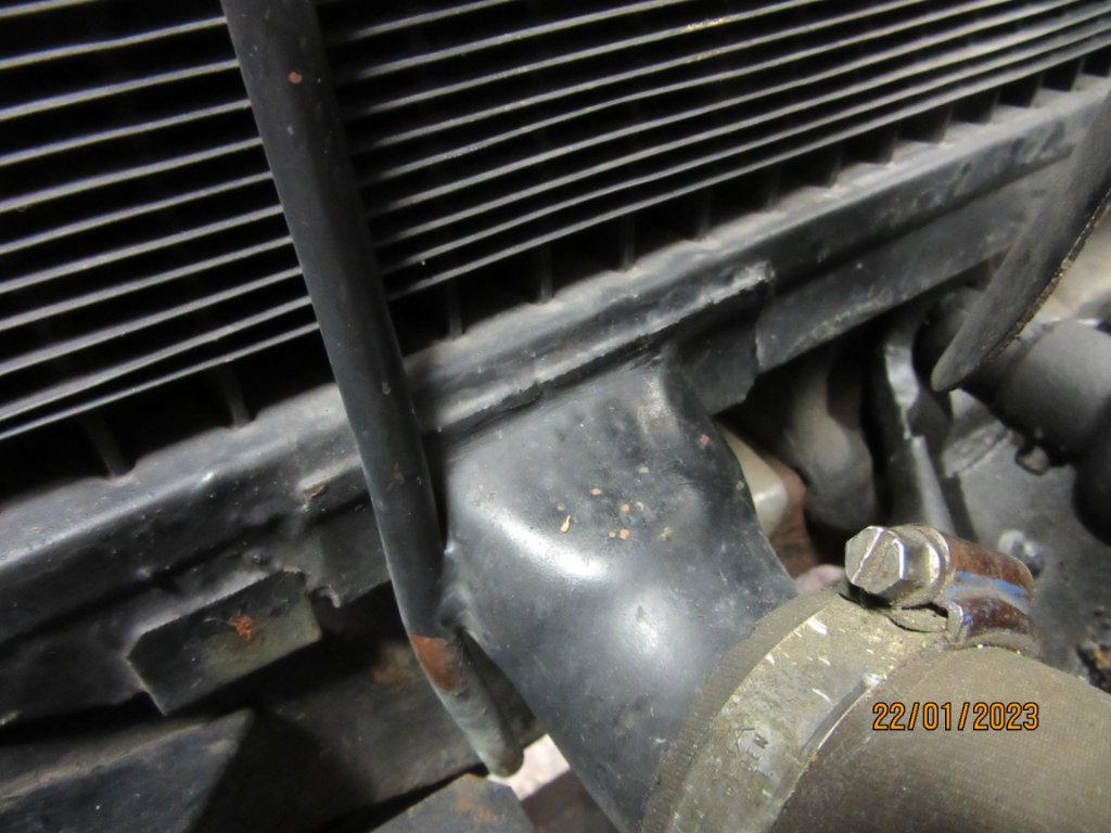

Years ago when the price for a new one was to much for me .
I bought a core the same size as the original with three rows of flat tube,s standing in an angle .
So the air go's [ swinging ] through the tube's
The top and bottem tank I made them by my self .
That was much cheaper , but it took some time . Toon

Anthonie
that's wonderful work. Thank you for sharing as an inspiration to others
