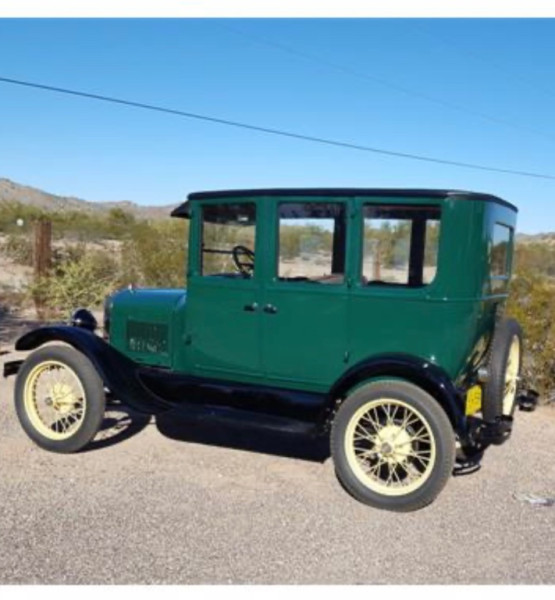

Considering buying a particular Model T 4-door sedan that I found on classiccars.com.
It's local but I haven't even looked at it yet but it does photo well. Not original but looks close to original from the outside. The drivetrain is off a 1978 Chevy Luv with an automatic transmission. From the photos it looks clean inside, underneath, and under the hood. And by clean, I mean spotless.
It is listed at $14,000.
Plan is to contact the seller and schedule a time this weekend to check it out in person. I don't know anyone personally who has knowledge of the Model T so I am appealing the bottomless pit of knowledge that is MTFCA.
Would appreciate any comments, suggestions, or advice.

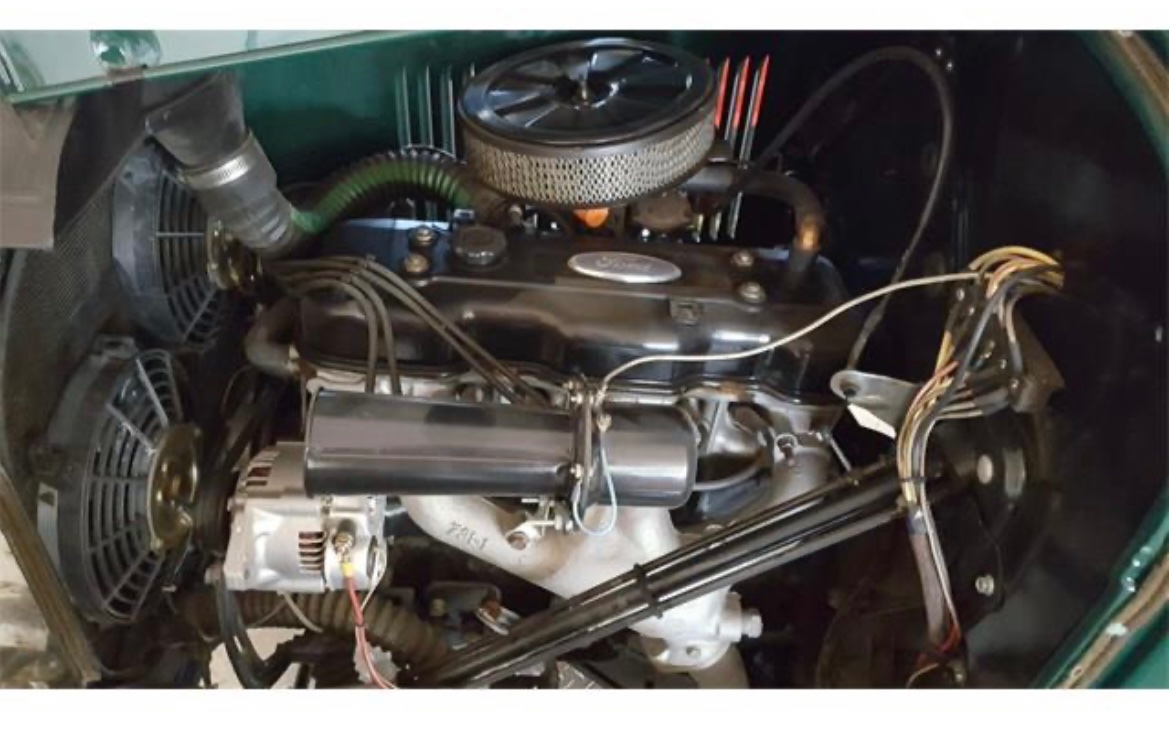

With a modern-ish Chevy driveline, the only thing anyone might comment on is the body. It's not a Model T, so if you like it and it suits your needs/desires, buy it. I cannot see how anyone in the "T" hobby will be able to persuade you one way or another...it's a custom creation and if that's what you're looking for, then I guess you've found it. If you're looking for an actual Model T, well, you haven't found it yet.

It's a Model T body on a later model compact pickup chassis. (I guess). It's impossible to tell from here if the resulting vehicle is a well-executed build. It's an odd duck, for sure.
What's it worth? I have no idea. I'd approach it with extreme caution. 14 K will buy a pretty nice stock or near-stock Model T, if you want a Model T. ** The Chevy LUV pickup was actually built by Izusu in Japan. As configured and sold in the USA, it has been out of production for over 40 years. Parts might be scarce.

It is definitely not a model t body on a Chevy Luv chassis. Just an engine swap. At least as far as I can tell.TXGOAT2 wrote: ↑Mon Jan 23, 2023 8:28 pmIt's a Model T body on a later model compact pickup chassis. (I guess). It's impossible to tell from here if the resulting vehicle is a well-executed build. It's an odd duck, for sure.
https://classiccars.com/listings/view/1 ... zona-85122

Adapting an 80 HP Izusu 4 cylinder engine and automatic transmission to a Model T body and chassis would be a major challenge. Not to say it can't be done, but it would not be an easy or straightforward job. Among other problems, the Ford T rear axle, driveshaft, and brakes would not be at all suited, nor would the steering system and front and rear suspension. Nor would the frame, radiator, etc. Then there is the matter of brakes. The Model T had no front brakes, and not much in the way of brakes at all. The T had no rear service brakes, no front brakes at all, and it depended on a single drum brake located in the transmission for general braking.

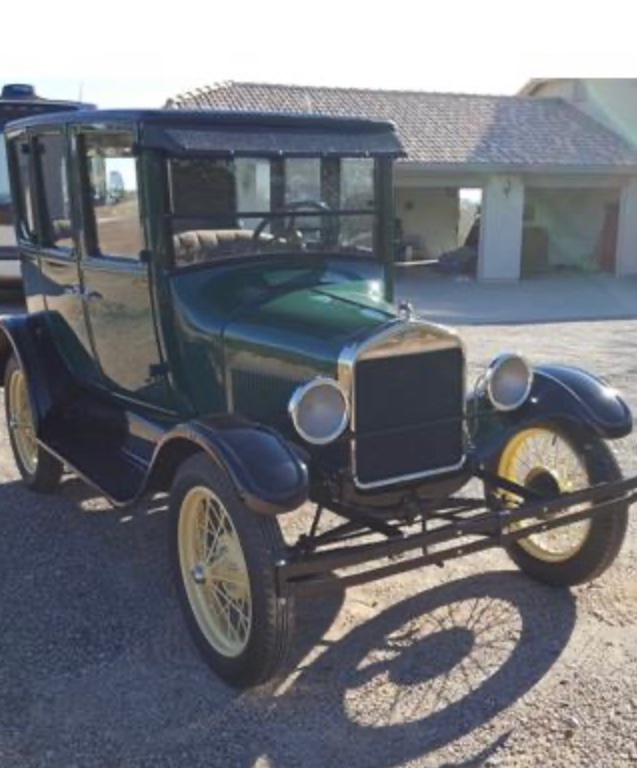

Indeed Morris, thanks for the link. The pictures show a nice looking 4 door sedan & based on the engine bay you shouldn’t have to many issues on cooling depending on your location but I would want to drive it a bit just to be sure overheating is not an issue. The frame & chassis picture wasn’t clear enough for me to see a lot of detail but from what I could see, if it is a T frame has had a lot of modifications but apparently no upgrade to the steering Per Pat’s comments do check on that braking. You’ve got a lot of weight mid frame forward. If you can get more pictures, do please post them.

Having now seen the candidate car, I have to ask: considering there are 100's of actual Model T's for sale in the USA every day, what is it about this particular car that appeals to you? Knowing that will go a long way toward offering you advice.

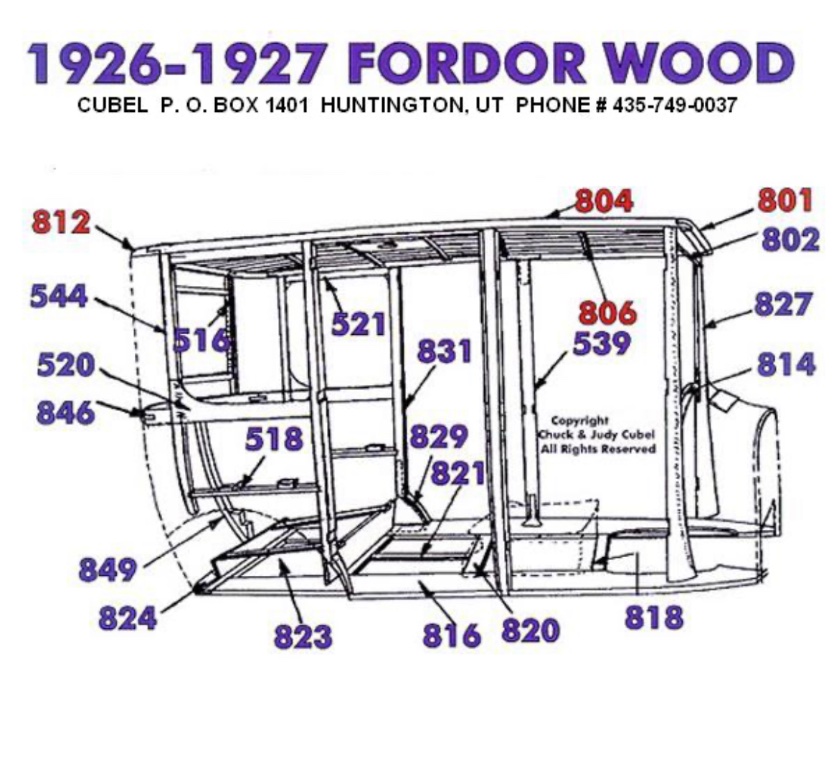

Morris it appears to be a Fordor which has significantly more wood in its skeleton than other 1927 models for a T.
I’ve got a 1926 Fordor & they are heavy T’s. Here’s a few pictures for the forum.

Images in the online posting appear to show the engine to be a nice fit and it's clearly not the original radiator. There are also pictures underneath but I don't know if the rear end is original or not but I seriously doubt it. There appear to drum brakes on the rear. The front axle looks to be stock. It's a solid axle with a leaf spring but I lack any expertise to know for sure. The steering system also looks stock which would make sense if the front axle is stock.

Wood pictured courtesy of Fordwood.com, I’d encourage you to make sure the wood is solid with little rot, if not run, run very fast.

This is very helpful. I didn't even know there was wood in the frame. Seriously! That fact alone gives me strong pause and warns me the tread lightly.

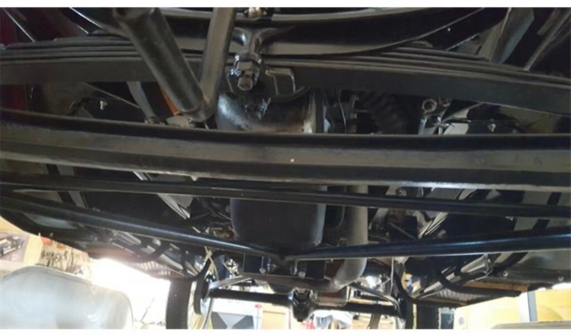

It does look good in the pictures. However, it appears to have a stock frame and front and rear axles, no front brakes, and probably stock rear brakes. The front radius rod socket would have to have been fabricated, and doing that correctly is critical to correct steering system function. If the rear axle brakes are unmodified, they are actually parking brakes, not service brakes. The Izusu engine has about 4 times the HP rating of the original engine, and should have a lot more torque via its automatic transmission. That could be a problem if the frame and rear axle are anywhere near stock. It appears that the car lacks front brakes. That's an issue, for sure. The vehicle could be safe to drive, if its limitations are respected. It might not pass state inspection. I'd want to check into that. The car may have cooling issues, as well as a number of other issues. If you're not well-versed mechanically, you need to have someone who is look the car over very closely. I'd also want someone with Model T experience to look it over, and give you some guidance on what is and what isn't actually Model T. It's a very odd duck, for certain.

Didn't look that close, but it looks like one of the few cars that was "adapted" with a Pinto engine in it since they fit in the engine space. Nice looking car, but....glad you're changing your mind. I could be wrong, but I swear this car was for sale for at least 2 years or more in various ads, including Hemmings. If so, there's a reason for that of course! Good luck.

The original Model T engine/transmission unit serves as a frame crossmember while providing an attachment and alignment point for both the front and rear axle assemblies. The engine/transmission unit also contains the car's service brake and universal joint. The brake, clutch, and gear shifting pedals and linkages are all part of the engine/transmission unit.
Replacing the Model T engine/transmission unit with any other type while retaining the Model T chassis and running gear is a major challenge.
In most cases, it's easier, cheaper, and safer to build or adapt an entire chassis to accommodate the T body.

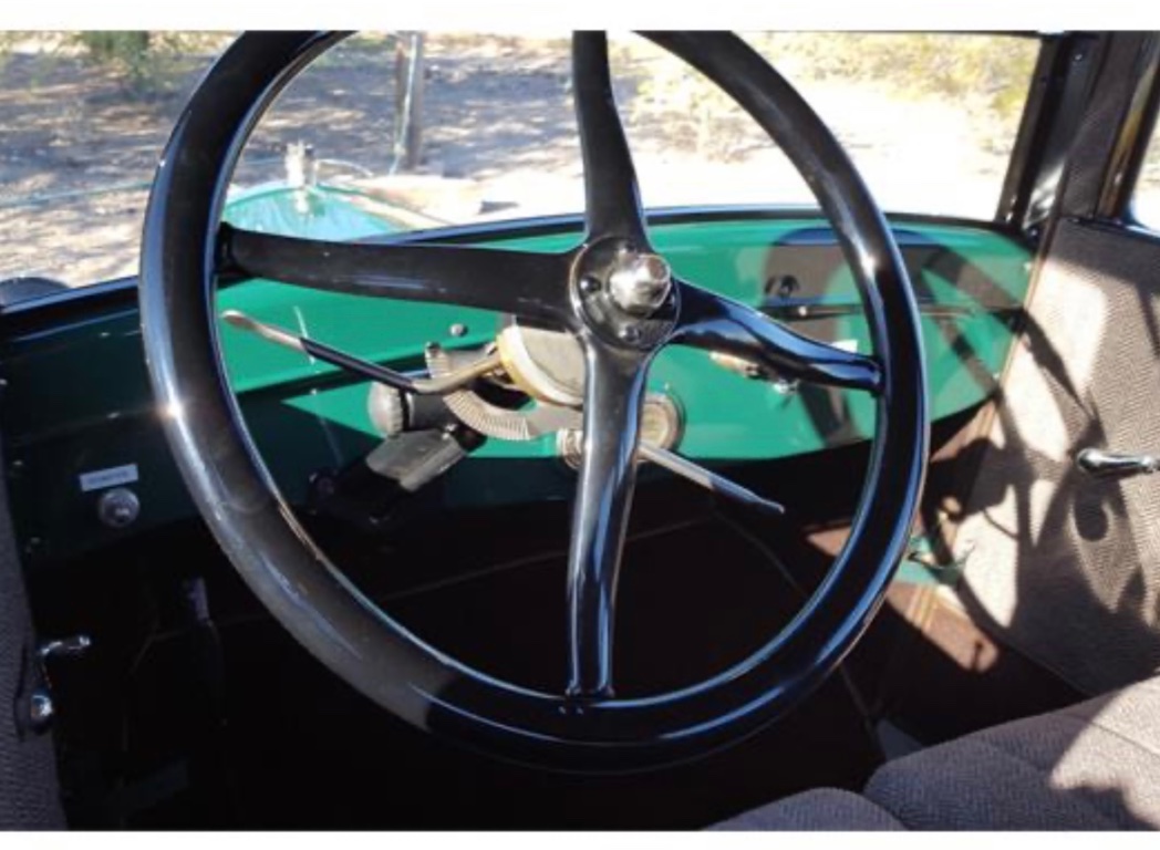

That will go fast enough to be extremely dangerous. It still has Model T steering, 2 wheel brakes of some kind, & a stock rear end that won't live well with modern power going through it. The wood in the body would be the least of your worries. I will say, it looks to be nicely done. If it came my way, I'd throw the engine away and re-power it with a T engine.
