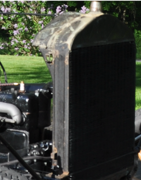

Of course, no one ever needed an original radiator repaired either, because they were just so darn well built.
new radiator picture.jpg (60.12 KiB) Viewed 8194 times
