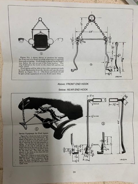

Post by Dan Hatch » Sat Jan 28, 2023 5:00 pm
I was cleaning out things and found this. Thought someone may want to make a set. They are the cats meow when it comes to lifting a T.

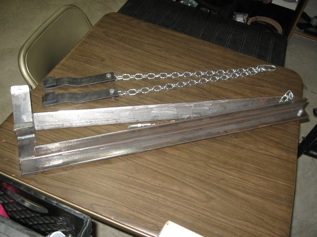

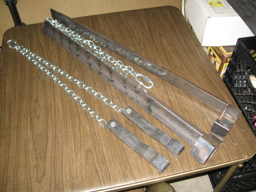

Post by CudaMan » Sat Jan 28, 2023 6:41 pm
R.V. Anderson was tooling up to offer both the front and rear versions of these when he passed away. I picked up the prototype set from him at Hershey last year. Here are pics of the prototypes. I don't know if any of the vendors who picked up his products plan to introduce them.

With engine pans, the front design would not work. I wish I had the rear lifting rig when I removed the rear axle from my car

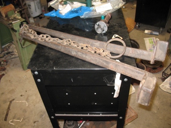

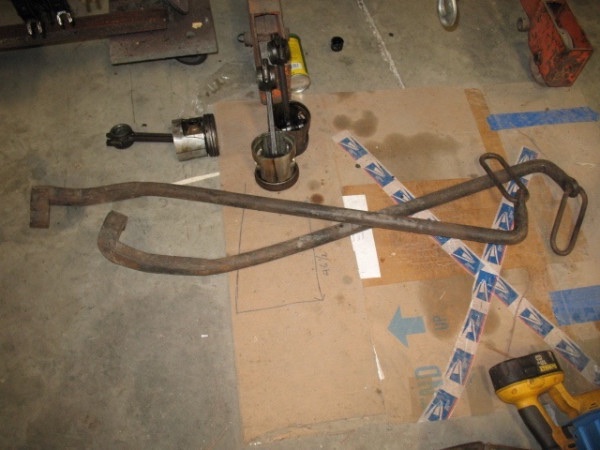

Post by Dan Hatch » Sat Jan 28, 2023 8:37 pm
Here are my sets.
Also have the front set but don’t use the often.

Post by GG Gregory » Sun Jan 29, 2023 7:18 pm
Who manufactured the original lifts like Dan pictured? I’ve looked mine over and can’t find a mark. They look a awfull lot like KR Wilson

Post by Dan Hatch » Mon Feb 06, 2023 3:43 pm
I will check mine for a name.
The long set I think was made by a Ford dealer. That is why the page with dimensions. Dan.

Post by KimDobbins » Mon Feb 06, 2023 7:05 pm
I saw the ones RV made at Hershey, but there were none in his shop after he passed, and I didn't find any parts or drawings. Maybe Don Lang found something related to the project when he was in RV's shop.
