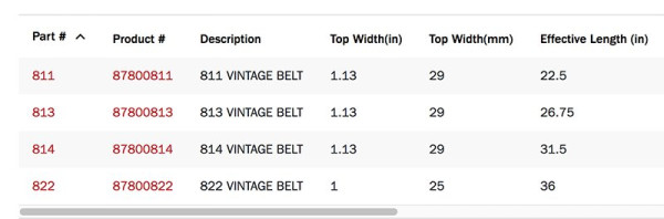

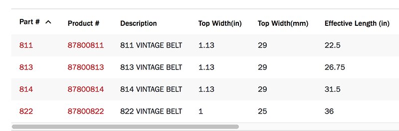

Re: Gates Fan Belt Size
I checked the Gates site for Vintage Automotive belts. This is what I found:
