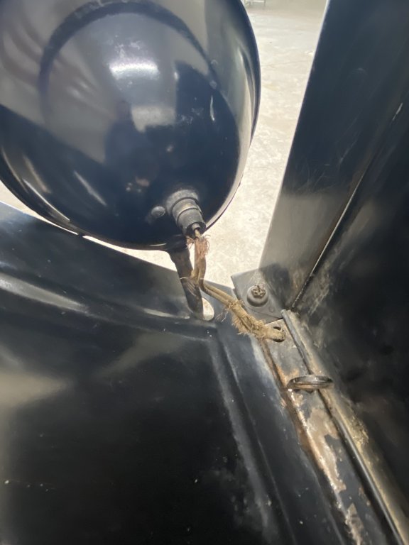

I recently bought a 1923 T. The wiring is terrible. I have looked at the catalog and have seen the wiring kits for the headlight. I don't see if there is a cover or grommet or rubber piece that goes from the wiring to the headlight. Is there a separate piece? Also, does the kit come with one side or do I need to order two to do both lights? Thanks for your help!

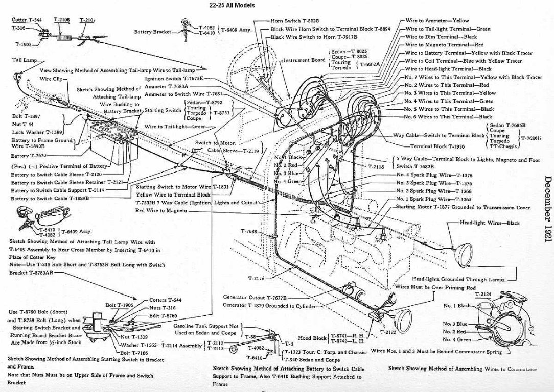

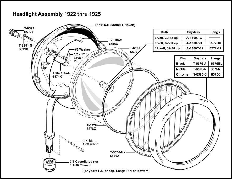

Some additional info to if you don't have
Wire information https://www.modeltford.com/model-t-part ... 1919-1925/

Thanks for the replies and diagrams. That really helps a lot!
