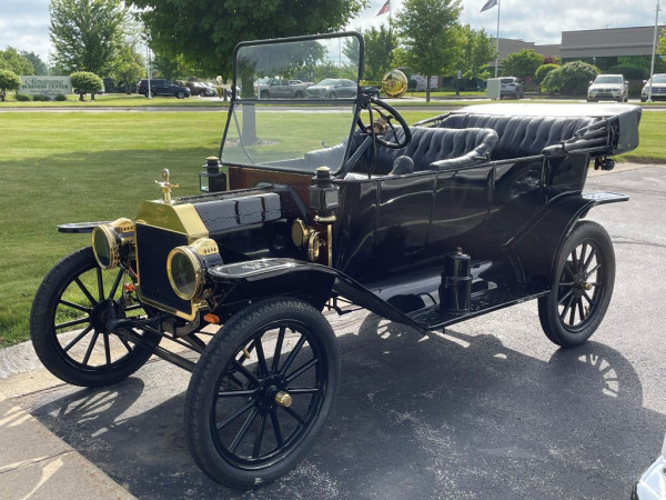

I have been asked to participate in a parade that runs every May between our local twin cities. The parade route is about 3 miles and is mostly flat, but there is only one small section that goes uphill over a bridge. I regularly drive my 1914 Touring in 90 degree weather and I don't have any problems with it overheating unless I sit in a long drive through line at an idle. I plan to add a water pump to my car to help it keep cool while sitting and idling. It is usually in the mid 70s during the parade...will adding a water pump be enough? Also, how will the clutches hold up with the car sitting at a stop idling and then crawling ahead slowly while idling for 45 minutes? (I have the factory original style clutches)
I assume many of you have been in parades. What problems have you run into?

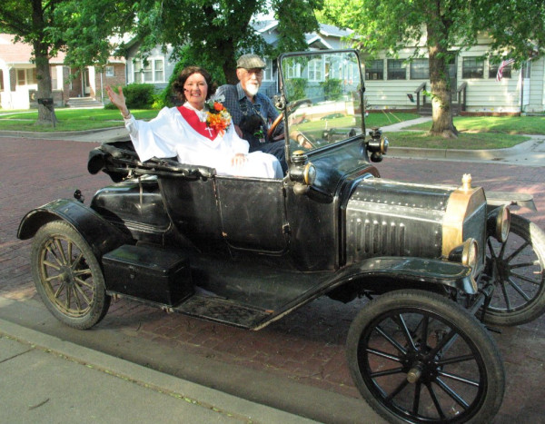

If it's properly adjusted the clutch will be fine. I haven't driven in parades, but when I drove Sister Aimee to the revival last May my 1915 runabout had to wait at idle for about twenty minutes. It didn't overheat. Recored radiator, no pump, temperature in the seventies. In a parade or anywhere else, DO NOT ride the low pedal. Some drivers hold neutral with the pedal. I wouldn't do that, especially in a parade. I believe it's better to hold neutral with the lever to be sure the band is not riding the drum. When engaging low gear it's important to do it as quickly as possible without stalling the engine, and mash it down hard. This applies especially if your bands have Kevlar linings.
