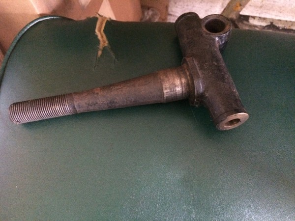

The spindle/wheel bearing threads are Rt hand on the left and left hand on the right.
I have a loose kingpin bushing on the left and found everything I need to replace them.
I also found a spindle that looks like new, bushings nice and tight with a NOS kingpin.
I plan on just swapping spindles, this one has RH threads, for the left side ??
Another question...
Do you think that replacing the spindle will change the toe setting much ?

There is a reason why they are threaded that way. They are threaded to loosen up when turning in the way the wheel turns when the car is going forward. The washer with the tab and the cotter pin keep the jamb nut in place and theoretically will not come loose while driving. However, when you have the spindle on the wrong side, the thread will tighten the bearing and could cause the wheel to lock up while driving causing you to lose control of steering. it might be possible to find a bearing of the right size without the threads and replace the bearing with the unthreaded one. The later cars from Model A on used the same type washer and jam nut so it should not be a problem with the steering if you use that type bearing.
Best fix would be to replace the bushings and spindle bolt and use the correct spindle.

Norm. I think this IS the correct spindle, just making sure before I take it apart.
RH threads is the left side, correct ?? That's what I gather form your explanation :)
I don' have the time now to change bushings and ream, find the tools...
I think I can just swap spindles in an hour or so.

In the condition that spindle is in (without the steering arm) you may also ID the spindle by where the steering arm enters. The spindle will have a healthy countersink to clear the radius on the shoulder of the arm and will have a FLAT face for the nut to seat on. Prior to '26, spindles are all theoretically interchangeable, though not identical. You would NOT want a '26-27 spindle on an earlier car unless they were matched as that would lower the front end. And yes, if you have a normal, right hand thread, that spindle belongs on the driver's side.

Looks like the passenger side spindle

Dave, To tell which side the spindle is for look at the whole where the arm goes thru and you will find a radius edge that goes on the inside, hold it so that the radius is on the insie this will let you know which side it is for .....

Easy spindle ID: the slot for the washer is always toward the rear.
