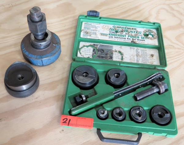

Re: Speedometer question
Not for an specific application but a tool like this knock out set have probably always been around for making nice round holes in sheet metal.

- Posts: 7913
I believe tool sets for cutting larger holes in sheet metal were sold as "chassis Punch" sets. Electricians may still use such sets for building control panels. McMaster Carr would have them. HVAC contractors may also use them. They make a factory quality round hole in light gauge steel.
