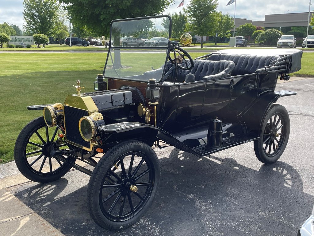

I tried using those LED lights in my 1914 Touring car and they were not very good. It did not help that my headlight mirrors were also scratched up. If I was on a country road with no traffic going slow they were OK, but as soon as there was a lot of traffic the only thing I could see was the light from other cars.
I replaced those LED lights with the Headlight Quartz Conversion Kit and they are very bright.

As for the turn signals....the only ones I could find at the time were kind that were on my Model A. They may not look like they should be on a Model T, but they are bright, reliable and the controller is easy to hide.
Here is where I got the kit...Item Number: 236-607
https://www.logolites.com/products/turn-signals/
If you select the picture you can zoom in and see them under the headlights and over the back fender.
