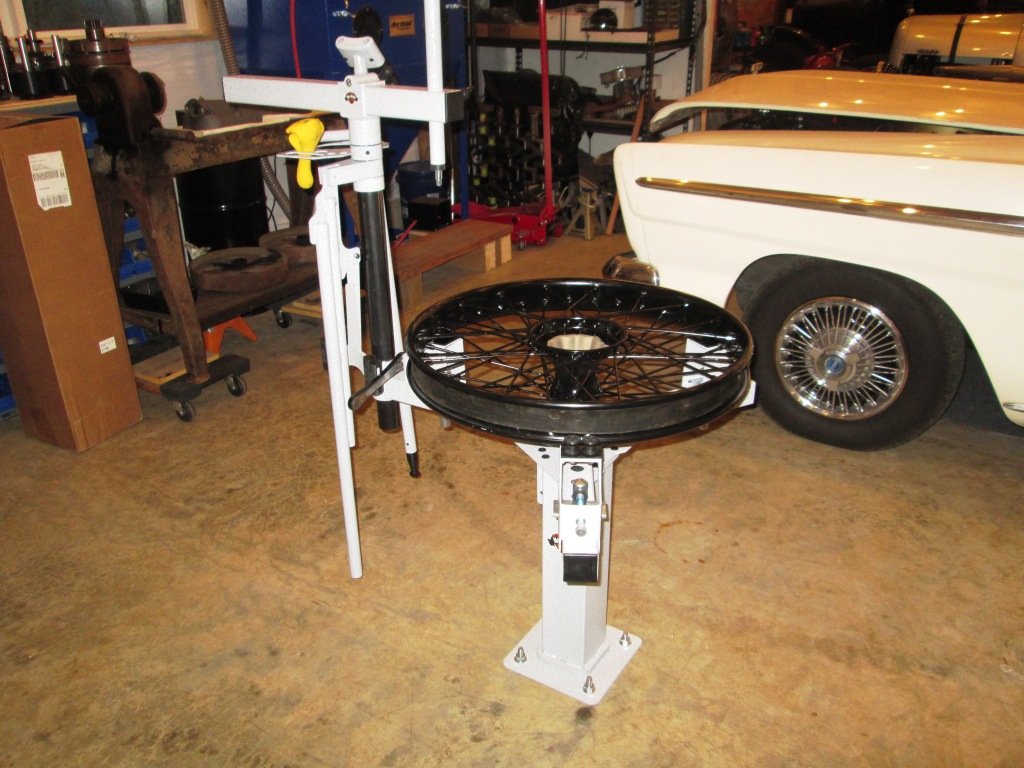

OR - you can purchase one of these - has a bead breaker too !
