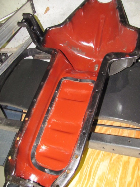

Post by DanTreace » Fri May 03, 2019 1:59 pm
Have used red Gyptol for many years on clean inside crankcases. Won't flake, and gives smooth finish for oil splash and drain out. Some bake it on, have just air dried and find it works just super for me.
IMG_6610 (450x600).jpg (134.84 KiB) Viewed 9059 times

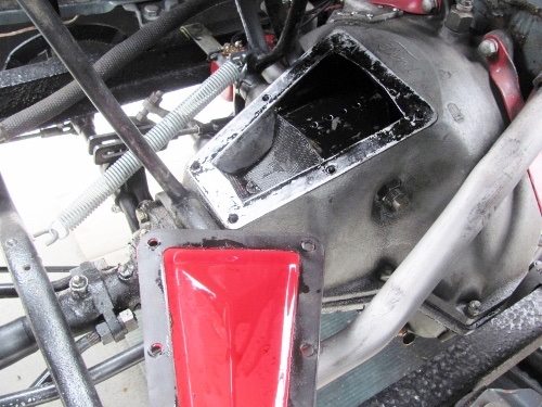

Posts: 4081
Re: Painting inside crankcase pan
Post by DanTreace » Fri May 03, 2019 2:07 pm
And, coated the inside of the hogshead too, plus the underside of the inspection cover. Nice smooth finish for the oil to flow over.
You can see the thin oil film sheeting down the Gyptol finish :P
IMG_6731 (500x375).jpg (131.61 KiB) Viewed 9052 times
