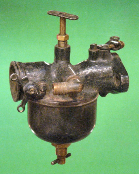

The Holley NH recommended by John and Scott was used on Fords during the years of peak production in the twenties, so it's very plentiful, and less expensive than most other Model T carbs. I have bought NH bodies or complete carbs at swap meets and auctions for $20 or less. As the other guys have said, it's simple and reliable. You can buy it rebuilt from one of the parts dealers. You can also get the MTFCA Carburetor book and do the work yourself. Nearly all the parts are available new. If you decide to go that route and need a new float valve, get one of Scott's.

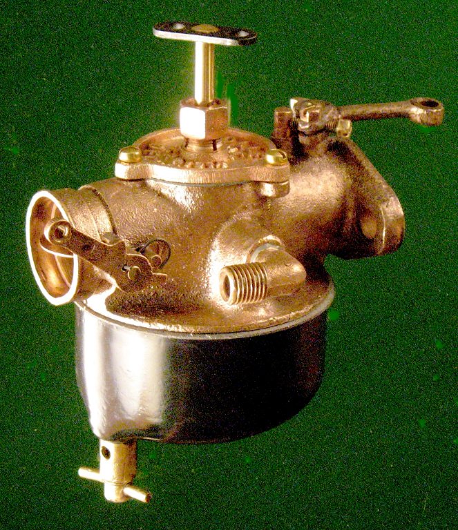

The Holley G Scott mentioned is less plentiful but still not hard to find. I've bought it in need of rebuilding for under $20, like the NH. But I've also seen it in need of rebuilding for over $200, so be careful. Some say it's as good as the NH, and some say it's better. Before 1919 it was made of bronze, and when you clean it up, Dang, it shore is purdy.
Holley NH. This one needs a new paint job, but it works.
Holley G. Before 1919 it's bronze.

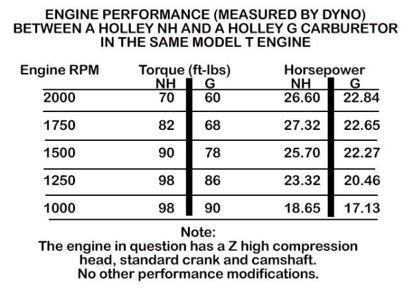

My 1917 came with a Holley G which I had rebuilt by Russ Potter. With it my car started easily and ran smoothly. Being a bit of an experimenter, I bought a swayback NH to see the difference. Other than being a little harder to start when cold, the NH appears to have more ooomph than the G.
When I had my transmission rebuilt and engine refreshed this past spring, the rebuilder put the engine on a dyno so I could see it running. Out of curiosity, we ran it with the G and an NH. Looking at the table below you'll see what I suspected about the NH was true, it did produce more power. I have since added Scott Conger's Full-flow valve to the NH which I believe further improves performance, especially on hills or when the fuel in your tank is getting low.
