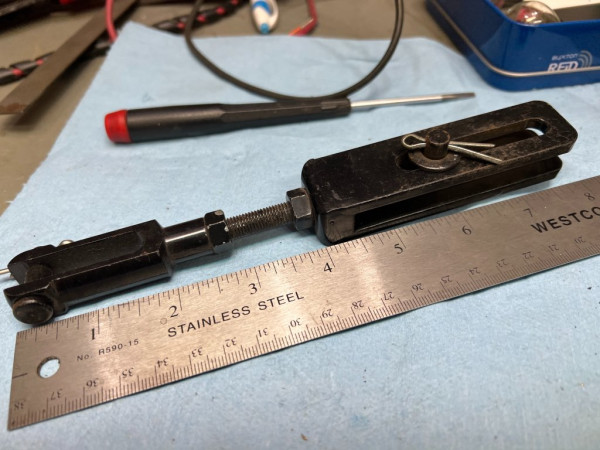

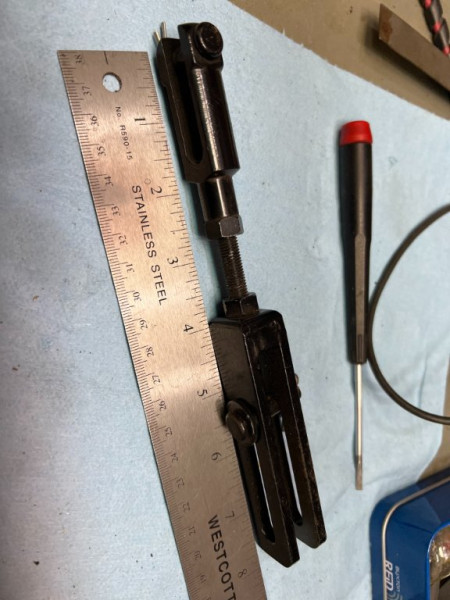

Anyone have the measurements of this by chance? I have an older set of Rocky Mountain brakes I would like to update.

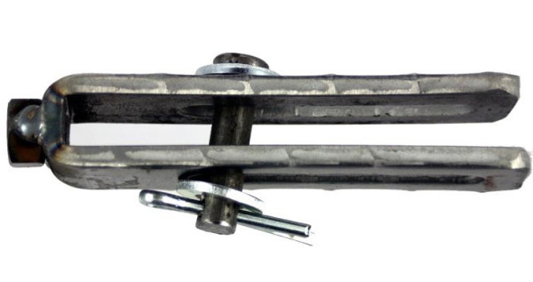

Our best Model T suppliers stock them for around $20. It sounds like you might be wanting to make one yourself. Heck- you can't make a homemade one for that little bit, if your time means anything. But, if you are like me, you may want to just to see if you can. :lol:

If it was twenty it would be a no brainer, but its over sixty and I can make one pretty easily.

It's 7.75" overall length

that appears to be a square nut,some flat plate,some threaded rod,a nut and some other stuff.about a hours work. I aint never made 70 bucks a hour! :D

Thanks be_zero_be

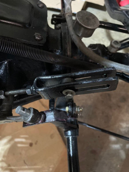

Anyone ever use two of these for 27 parking brakes to increase the throw on the handbrake lever?
In my situation, the brake lining is too close to the drum surface resulting in the brakes being activated too soon when I pull on the lever. If I loosen the rods to eliminate early engagement, the car won't slip into high with the handbrake brake released. Its not an adjustment issue.
