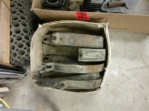

What is differance between the narrow and wide bands??

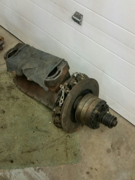

The wide bands are for a 26-27 transmission brake drum which is wider. Your transmission appears to be an earlier narrow brake drum so all of your bands will be the same width. Good luck witj your project!

The wide band is for the rear-most drum (brake) on '26-27 engines.
The engine/trans that you have posted a picture for is a pre '26 engine which takes all 3 narrow bands ( the brake drum is not wide)

Thanks!. the block I am using Date codes to about 1924.Chris Instness wrote: ↑Thu May 02, 2019 10:48 pmThe wide bands are for a 26-27 transmission brake drum which is wider. Your transmission appears to be an earlier narrow brake drum so all of your bands will be the same width. Good luck witj your project!
Would the wider drum 26/7 trans fit an early car? Or is it a bit longer? driveshaft shorter??

The 26-27 transmission will fit in an earlier car, but in order to use the wider band you will need a 1926-27 pan and a 26-27 hogs head(transmission cover). The pedals can be swaped but the spacing on the 26-27 pedals are wider where the come through the floor board. It is also recommended to use pan corner reinforcement supports if you are using a 26-27 pan on an earlier motor.

No shortening of the drive shaft is needed to change to a 26-27 transmission.

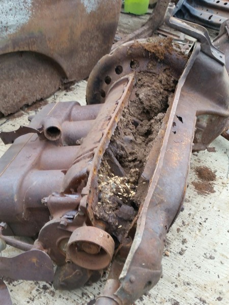

I got this one (previous post) unsiezed, so hoping for the best. block frost cracked in several places.John kuehn wrote: ↑Fri May 03, 2019 4:54 pmDon’t give up on the seized engines! More than a few rusted up and seized engines have been saved or brought back to life. Same goes for T Transmissions. A good soaking in kerosene, diesel and patience will sometimes surprise you.
Got students at welding school to weld up, at least give it a chance.
Got all valves cleaned up and seated.
Now to work at getting ignition that will work, from piles old rusty stuff lol.
And have another one soaking, see what happens.

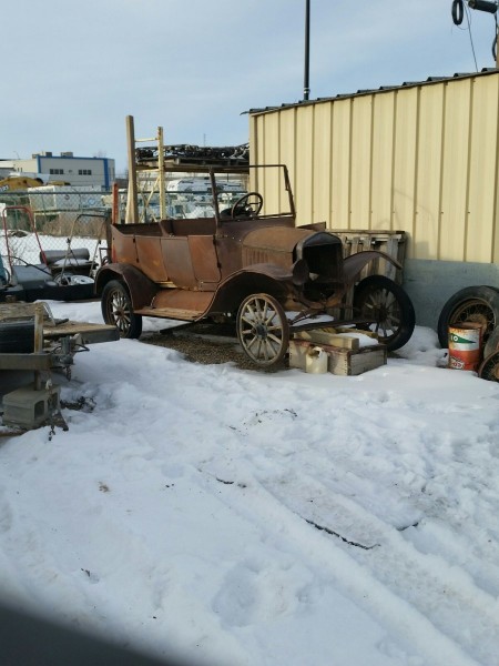

This other engine (in post) went into this yard art open car, engine way beyond hope..
