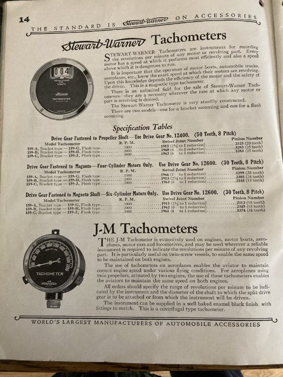

I have read with interest the comments about attaching a tach to a Model T. I've attached a page from the Stewart Warner catalog #22 that describes the attachment. Note that the tachs use a swivel joint just like the Stewart speedometers. I hope this helps. Russ Furstnow

Cool Russ, nice one! I forgot I have seen that catalog at Daves’. Do you or does anyone have any pics or ever seen one of the “swivel joints? How and where would one mount it to the “propeller shaft”? The earliest tachs I have are late model A era and low rpm but no idea what the mechanical output looks like or what they were intended for. I have personally only seen V8 era and or WWII military use mechanical senders that mount on the crank snout, or distributors with built in cable drive. I bet there’s examples in early track racing cars which were scratch built. I haven’t really dug into it too much but I’d guess that tractors and other industrial engine apps would be more likely to have tachs and usually have hour meters especially if a governor is in place. Perhaps there is a more commonly made and sold part from the T era that would have been collected by equipment restorers or museums that can be adapted? -Chris

Chris,
The swivel drives noted in the specifications are just the "normal" swivels used during the period. Some are left hand drives and some are right hand drives. The ratios go from 2.5:1 to 6:1 based upon the tach rpms. I have not seen a standard tach drive mount as it would depend where the drive would be mounted. Russ Furstnow
