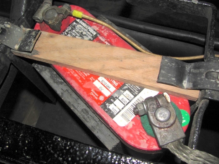

I've had good results with an Optima Red Top 6 volt battery and stock generator for the last 2 years, but I don't know how old it is.
