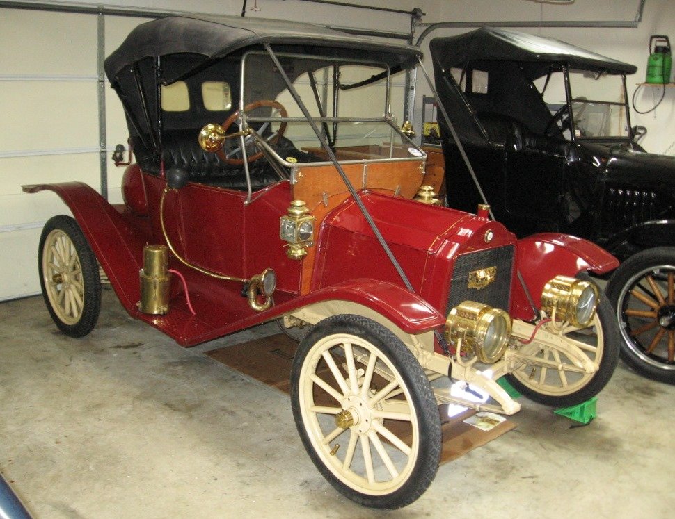

I needed to find matching touch-up paint for the maroon body and cream chassis colors on my 1912 Flanders 20.
I removed a couple of parts painted each color, cleaned them up, and on a whim I took them to the local Home Depot hardware store (!).
Turns out they sell 7 ounce "color test" jars of enamel that can be computer matched to the color of your parts. The computer only scans a small, thumbprint size section, so you can point out to the operator what section of the part you want scanned. It only took ten minutes or so for the paint to be mixed and ready.
When I got home and tried out the new paint, I found that the cream color was a perfect match, but the maroon was a little light. I dripped a little Rustoleum gloss black into the maroon jar and brought the maroon to a perfect match as well.
