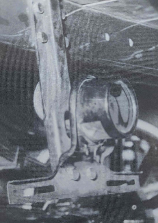

From Bruce's Book, bracket shown is used under a pickup. Might or might not be what was used on a TT.

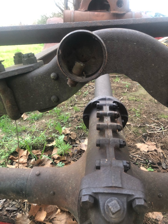

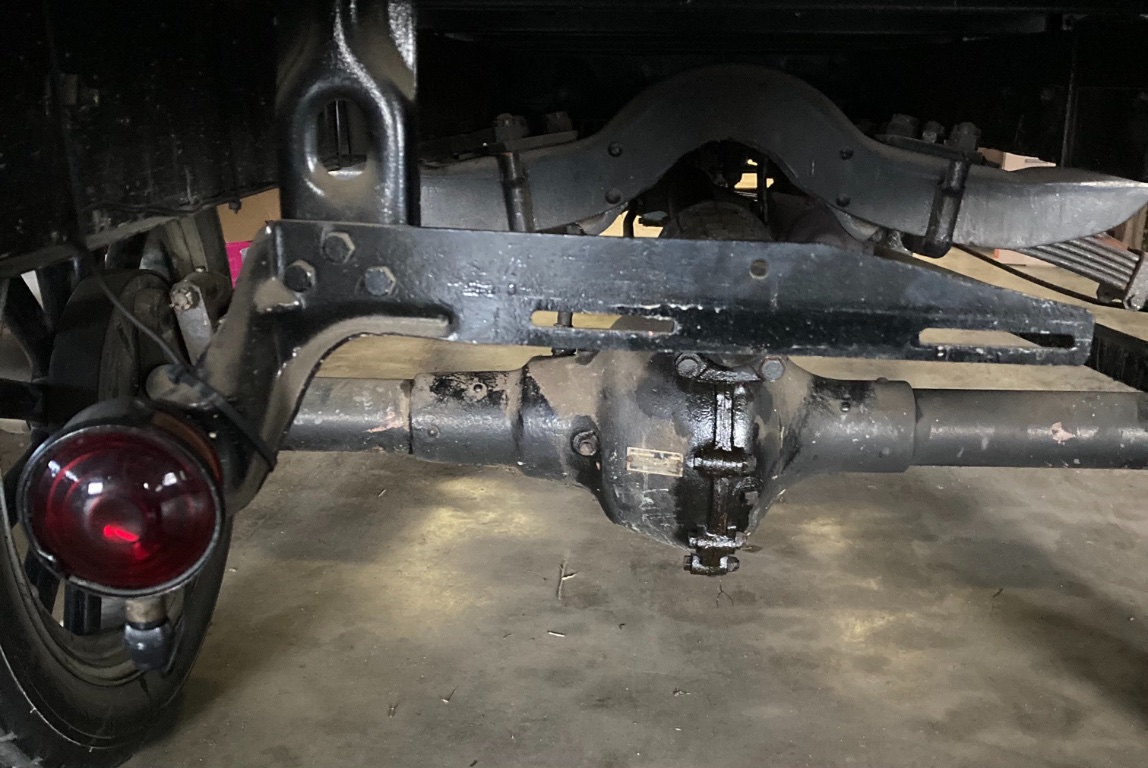

To answer your question of appearance of TT rear license plate bracket, here’s what to look for. Colloquially called a ‘butcher knife’ bracket, they’re very difficult to find. The bracket bolted to the crossmember (4 bolts) in my picture is repopped by our suppliers. The horizontal bracket is not

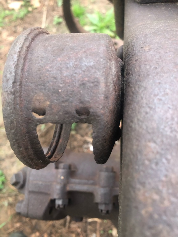

I wonder if this is factory or something somebody did on their own? It’s on a chassis I bought last year, attached with a step bolt to the crossmember, license plate light shines to the right but no bracket for a plate. I can’t find a serial number on the frame but it has the late rear axle and came with a 4 dip pan and a 1926 block.

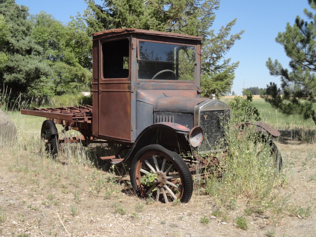

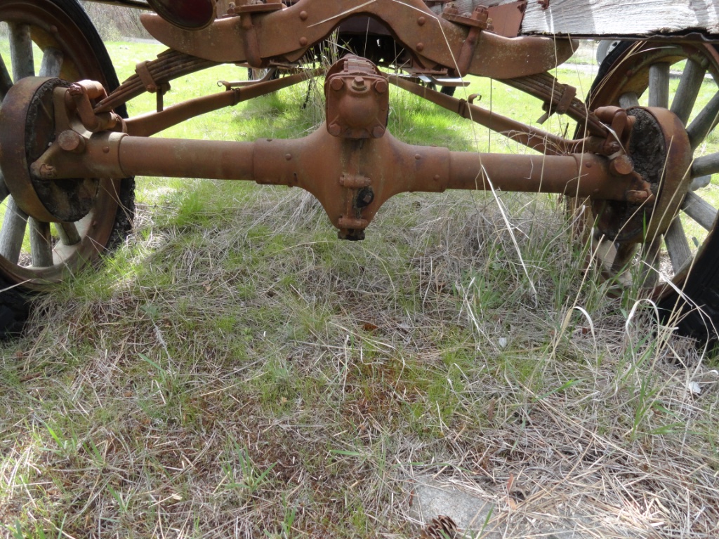

My first TT was retired from licensed road use when the 1947 plate ran out.
Owned by the man I bought it from since 1955. He said the truck was exactly
as he bought it in 1955 when I bought it from him. It had one kerosene running
light bracket present, and holes were there for the other. No tail light bracket
was present.
The TT I have today is nearly identical in many ways. I am the 3rd owner, the
2nd owner only had it a short while. The original family (farm truck) had it for
80+ years. Are the kerosene running lights added ? The correct battery box is
long gone and the tail light bracket is Farmer Brown made. It has a kerosene
tail light, as well at the electric one. This truck was never let "go to seed: or
been "restored". Just kept "nice", making fixes and repairs as needed over the
years.

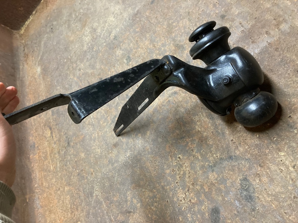

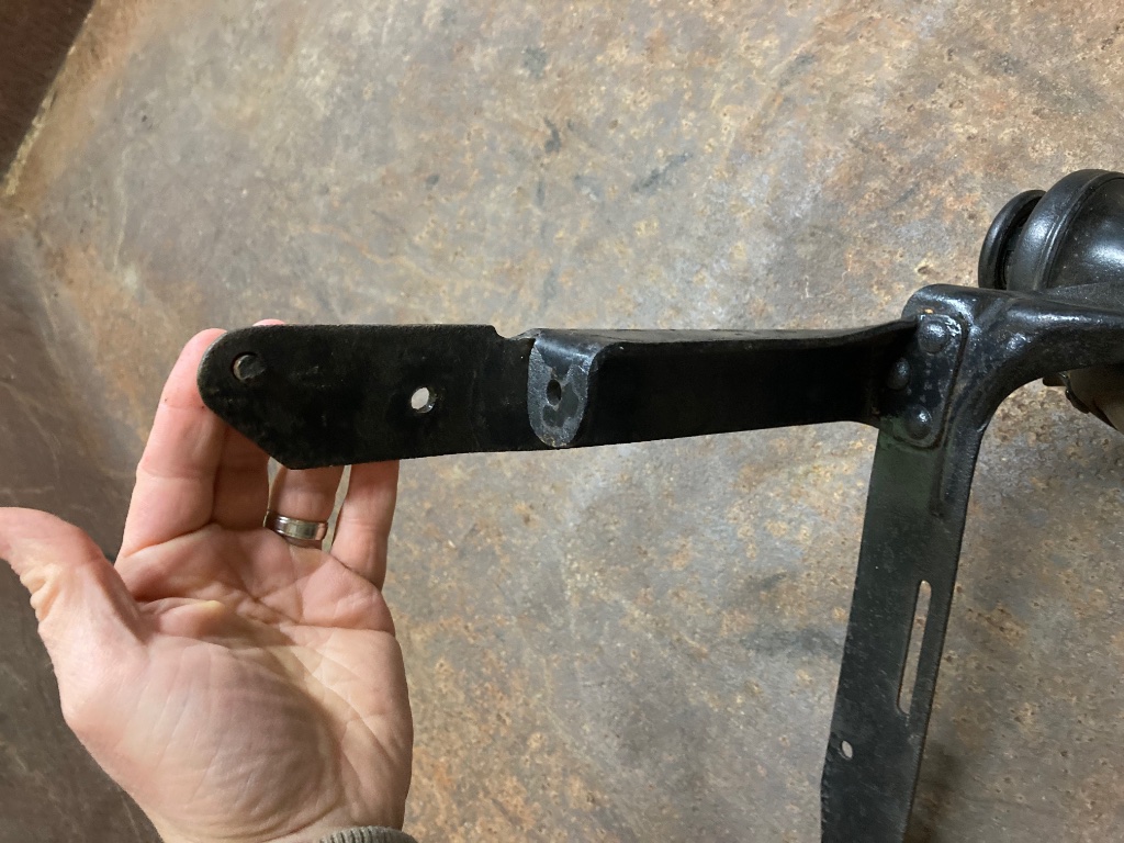

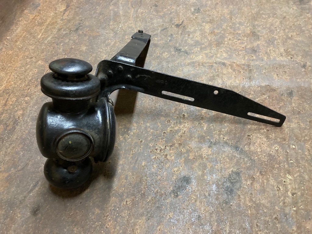

Thank you everyone for the help and pictures. I was lucky enough to find a “butcher knife” bracket at the Marietta Ohio swap meet this Saturday! Does anybody know how this would mount onto a TT? I can’t seem to find where the holes would line up. The bracket and bolt holes looks similar to a spare tire bracket for a touring or roadster.

Re: TT question
Howdy Nathan,
Remove that partial spare tire bracket in your left hand. Now buy from our vendors that repro ’vertical’ bracket (sorry, I can’t attach a catalog picture). It’ll bolt to the Ford Truck steel bed crossmembers with prepunched holes in both. It’ll also bolt with 3 prepunched holes to that butcher knife bracket.
- Posts: 2061
- First Name: Jeff
- Last Name: Humble
- Location: Charlevoix, Mi
- Board Member Since: 2006
Re: TT question
A Ford bracket will probably not work with a non Ford dump bed. You will need to improvise.
