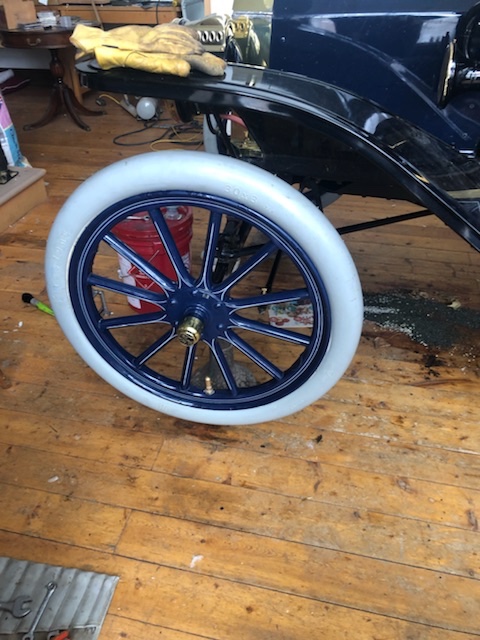

Hoping I don't regret the choice, I put a set of grey "smoothie" Firestones on Lizzie, they were offered as a deal I couldn't turn down. I reckon I'm no worse off at worst - the T-Drivers that were on were worn bald, so traction is at par :lol: and they're "cute".
The T-Drivers were "oversize", and the rear 30x3-1/2" tires ran awfully tight to the running board. I presumed the Firestones are what "regular" 30x3-1/2" tires were "in the day" ? Their circumference mounted and inflated is 98-3/4", which makes the diameter 31-7/16". Oversize ? They look "big" but they're not crowding the running board as tight as the T-Drivers did.
The front 30x3" tires measure 95-1/2" circumference, equals a diameter of 30-3/8". Thoughts ?

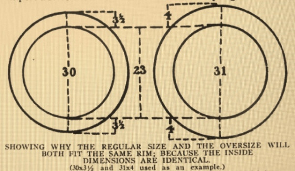

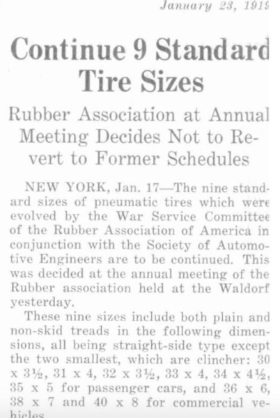

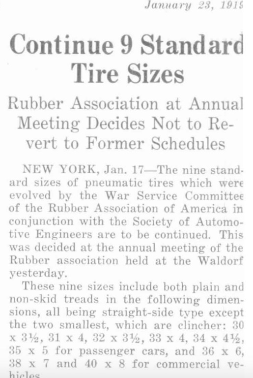

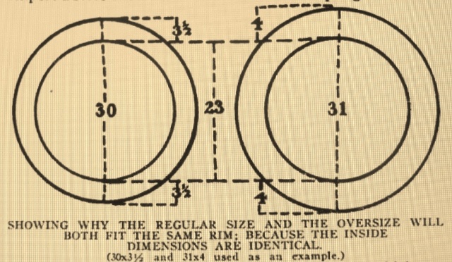

Scott provided the answers, that today we only have the 'Oversize' or 'Extra Size' which in reality is the next size up clincher tire, the 31"x4".
Note the the article states, straight sided tires, except the two smallest, for clincher. So only the 30" x 3 1/2" and the 31" x 4". size clinchers were manufactured due to war costs. Then the market went to the Oversize for the Ford, as more miles per $$ ;)
