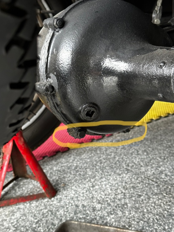

My ruckstell is leaking fluid from the highlighted area. Do I need to worry and how can I fix it? Thanks!

What is the grayish material near the bolt above the filler plug?

...I tried to stop the leak by smearing gasket maker on it. It didn't work.

Have you tried cleaning the area up and then trying to pinpoint the leak source? It can be hard to determine exactly where a leak originates. Does it leak when parked for several days?

It always leaks, its been leaking all winter as it just sits, its a real slow drip, a few drops a day as it sits cold, or maybe a couple of tablespoons or so after a drive. I top it off every few days during the summer.
It seems like its leaking around the bottom two bolts, but they are tight.
