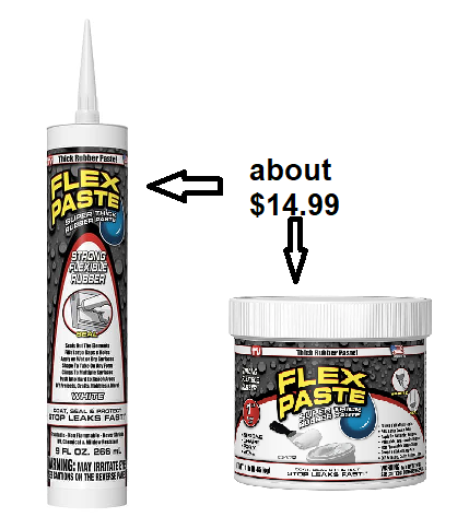

I would think that a pad would only prevent some wear from metal to metal contact and not act as a cushion.
I'm planning on coating mine with Flex Seal Paste. I used this before and it dried to a hard rubber surface. The only concern is how tight a bond it will make with the metal. But its worth a try and same concern with other methods. I didn't use all of the contents of the jar in my last project and it dried hard after a few weeks when it was sealed tight. Thinking the tube might last longer since just the tip is exposed to the air.
flex seal.png (131.54 KiB) Viewed 1017 times
