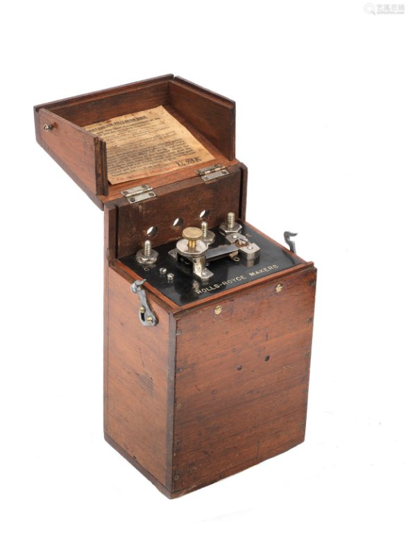

I found this on an on line auction site:
""A wooden-cased trembler coil for early Rolls-Royce cars,varnished wooden case with angled lid, opening to interior containing trembler coil marked 'Rolls-Royce Makers' with vibrator and contact points and terminals, the inside of the lid stamped '37' and with instructional label, the case measuring 24cm high.""
