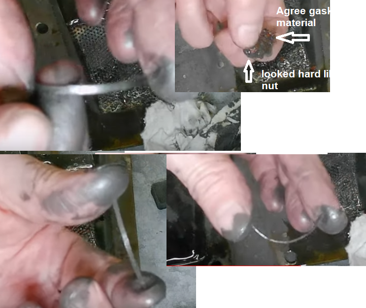

Posts: 6552
Re: Requesting "Think tank"
Post by TRDxB2 » Thu Mar 23, 2023 12:49 pm
TheSpeedsterProject wrote:
Wed Mar 22, 2023 9:04 pm
I had the inspection cover open recently (filmed that too - oil change video), didn't see anything wrong. It still rolls free ................
I posted this in the "other" discussion ion the same issue
You'd better ID what you found in the oil screen and drop the the inspection pan to see if there is more of that!

Posts: 5169
First Name: john
Last Name: karvaly
Location: orange, ca
Post by speedytinc » Thu Mar 23, 2023 1:46 pm
Only You know what You put in this motor You rebuilt. Do confess, so no one else makes a similar mistake.
Thats some nasty goo. :shock: :shock:
Root canal time!
I wouldnt do any less than than a complete disassembly & cleaning. (including oil control rings)
That goo looks thick enough to plug & restrict any & all internal oil entry points.

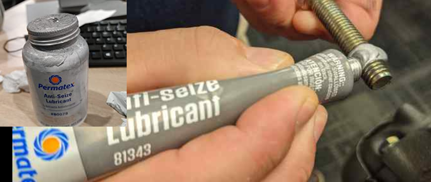

Posts: 6552
Post by TRDxB2 » Thu Mar 23, 2023 2:12 pm
speedytinc wrote:
Thu Mar 23, 2023 1:59 pm
Tripple gear bushings are prone to locking up, so extra clearance is a good idea during a rebuild.
Even with extra clearance, they cant be run dry.
That goo will not lube those bushings or the drum bushings either for that matter.
Lurching problem solved.
I hope you will be able to disassemble the transmission without destroying it.
There is bound to be some galling @ the least.
Doesn't that goo look like anti-seize, they way it sticks to fingers etc

Posts: 5169
First Name: john
Last Name: karvaly
Post by speedytinc » Thu Mar 23, 2023 2:28 pm
It does, but, Why would there be 2 tubes worth in a motor??
The grey color is commonly indicative of iron shavings from the cylinders. Chrome molly rings? or just the lack of lubrication.
