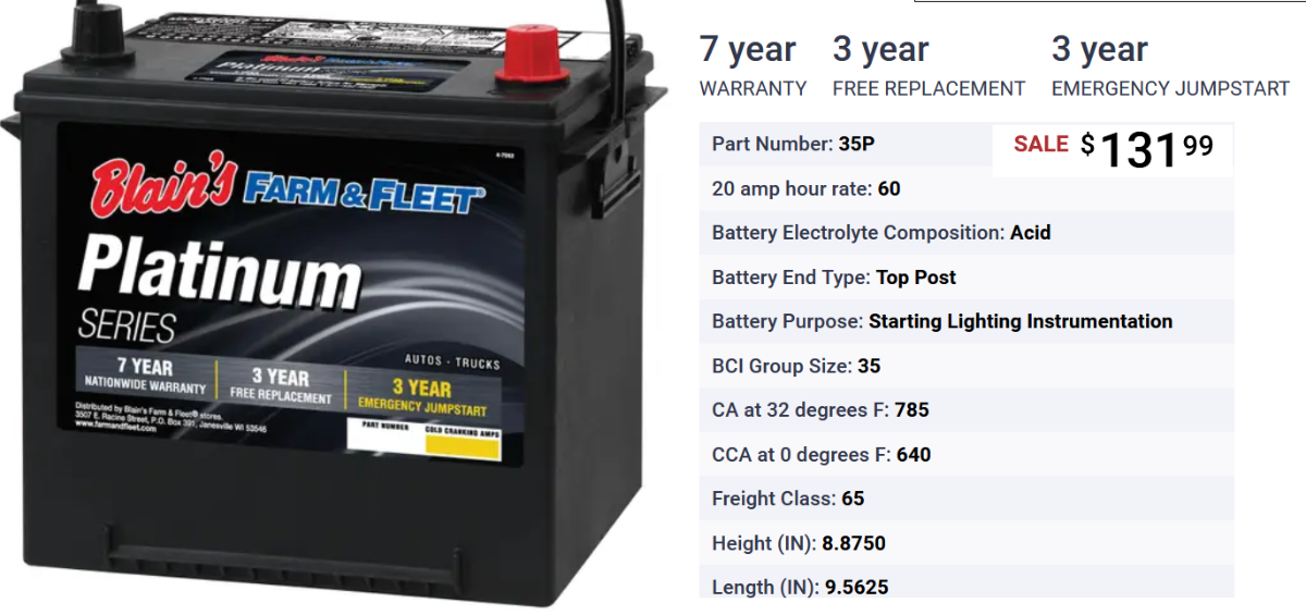

I am guessing that you have the 12 Volt Group size 35 battery [ approximately (LxWxH) 9 1/16 x 6 7/8 x 8 7/8 inches (9.0625 x 6.875 x 8.875 inches, 230 x 175 x 225 mm) ] which matches closely to a 6v Group 1 size normally used. Length: 9 Inch Width: 6-7/8 Inch Height:8-3/4 Inch
I've had been checking to see how many battery manufacturers were still in the USA and it appears that what ever you buy is made under parent company Clarios, who bought Johnson Controls. Batteries brands are made to retailer specifications but no doubt they are much the same.
I have always replaced any car battery I have every owned with one from Blain's Farm & Fleet, and never replaced one of theirs. So head down to 405 W 8th Street and get one! Note the warranty is better than the 12volt Red Top Optima (3 years)
Blain's CA:785 CCA: 640 Reserve Capacity: 95min
Red Top CA: 910 CCA: 720 Reserve Capacity: 90 min

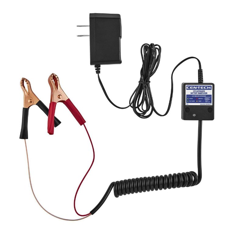

I Use a cheap Harbor freight $10.00 12 volt battery maintainers on all my batteries that are not used much. Model Ts. Generators. lawnmowers ect. Have a cheap Walmart 12 month warranty economy battery on my 1988 S-10 pickup parked in the barn which is only run every few months. battery is about seven years old. Battery still spins the starter no problem. Battery maintainers work.

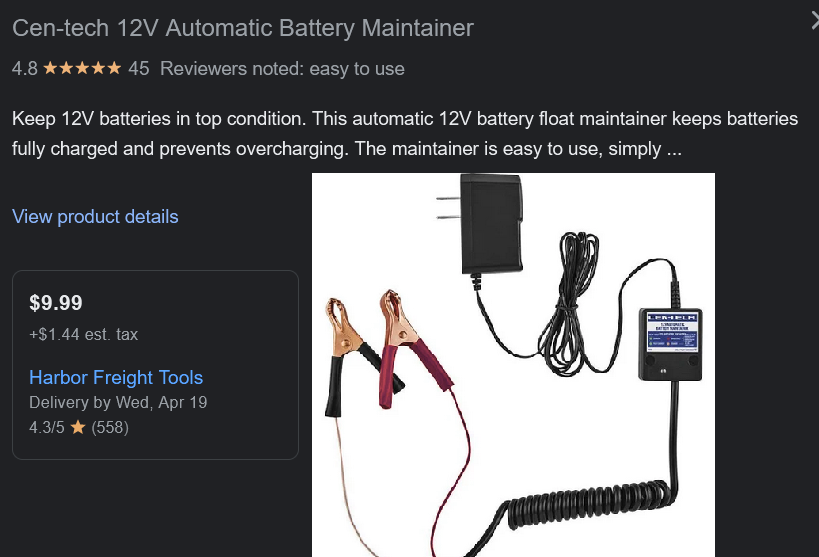

Technology has changed chargers. The Harbor Freight item is a "Battery Maintainer" (some times called a battery tender), a smart trickle charger, that monitors the battery to prevent overcharging

I also use the Harbor freight battery maintainer on my whizzer moped which uses a 12 volt one amp sealed Gel Cell battery. Keeps it fully charged and never had a problem with over heating. The one amp battery is pretty small but does the job. Just don't leave the key on for more than a few minutes with the motor off since the headlights and tail lights come on with the key and 12 watt hours of power doesn't go far. Need to convert it to leds but the headlight uses a dual filament motorcycle bulb for high / low beam which will be hard to duplicate in a led bulb.
