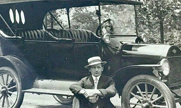

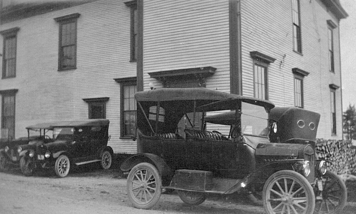

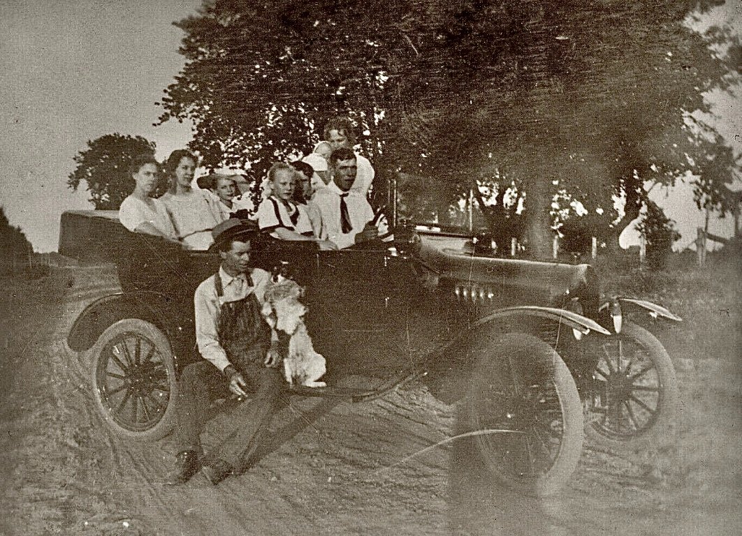

Post by Wayne Sheldon » Sun Mar 26, 2023 7:16 pm
There were also after-market cover shells and hoods made and sold to "update" the look of late brass era cars.

Post by Wayne Sheldon » Sun Mar 26, 2023 7:23 pm
Seemed to be an upload glitch adding the photos?
