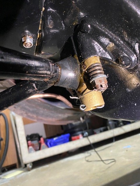

The front yoke ball, that seats in the oil pan, is exposed to road dirt, and water, since it is unprotected in any way.
I have been occasionally removing the APCO cover, and cleaning up the old grease and dirt and re-greasing the ball and related parts.
While staring at it, I thought of an easy way to make a protective rubber boot, to keep the grease more or less in place, and the dirt and water out of the assembly. I bought at the auto parts store, a universal replacement tie rod rubber boot, and I used a gasket punch and a hammer to increase the diameter of the small end, so it you simply stretch it and pop it over the ball, and it fits the shaft just behind the ball snugly. I then packed the inside of the boot with fresh grease and when re-assembled on the oil pan, it looks like this. While it may not keep 100% of the dirt and water out, it has to be an improvement in that direction. The rubber does not interfere with the movement of the ball in any way.
It is just what everyone likes, simple and cheap, and works!

Re: A protective boot for the front yoke ball
The Apco ball cap has its own spring, using 2 springs on the studs makes too many springs. Use the Apco, or the stud springs, not both. IMO the Ford spring loaded ball cap is a good design and better than the Apco. Where the Apco spring loaded ball caps shine is on the steering drag link.

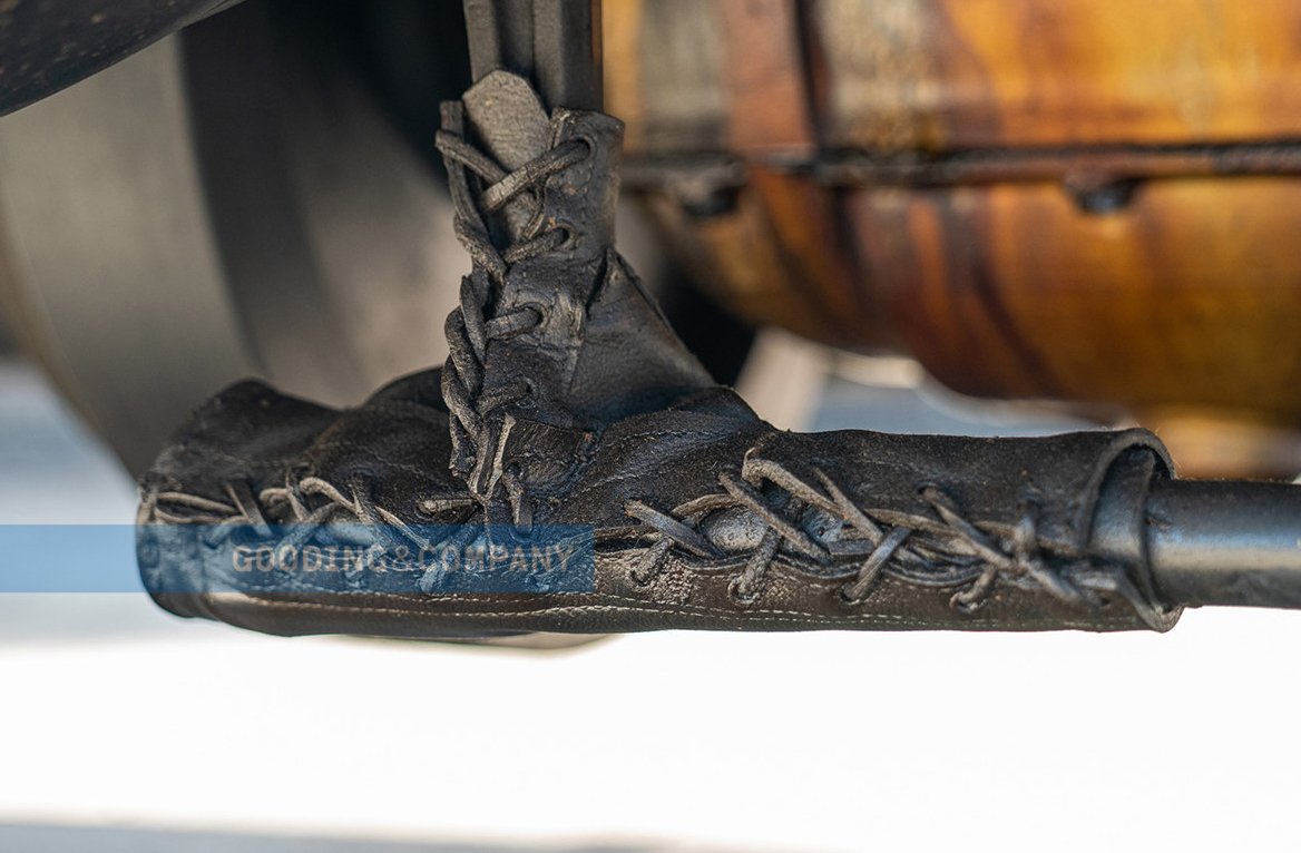

Many cars had fitted leather boots that were laced over steering knuckles, u-joints and such places to keep grease in and dirt out.
It is a great idea.

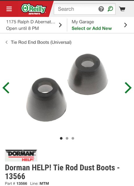

I neglected to post the part number and source for that replacement rubber boot. I bought them from O'Reilly auto parts, but they are made by Dorman products, and one should be able to find them locally, just about everywhere. As I said before, you have to enlarge the small hole in the end with a gasket punch and a hammer to get it to pop over the ball.

When using the APCO unit, you can run the nuts up tight compressing the original springs, which then act like spacers.Humblej wrote: ↑Tue Feb 14, 2023 4:16 pmThe Apco ball cap has its own spring, using 2 springs on the studs makes too many springs. Use the Apco, or the stud springs, not both. IMO the Ford spring loaded ball cap is a good design and better than the Apco. Where the Apco spring loaded ball caps shine is on the steering drag link.
I finally found a photo of the type of boot I was describing above. This was on the Gooding&Co site.
Period and authentic.
Hi Craig, Love your idea! It looks like a perfect fit? Did you feel this was the best size to order after your install? What size hole punch did you use to end up with a nice tight fit? I see a Rockauto price of 3.50 for two!
