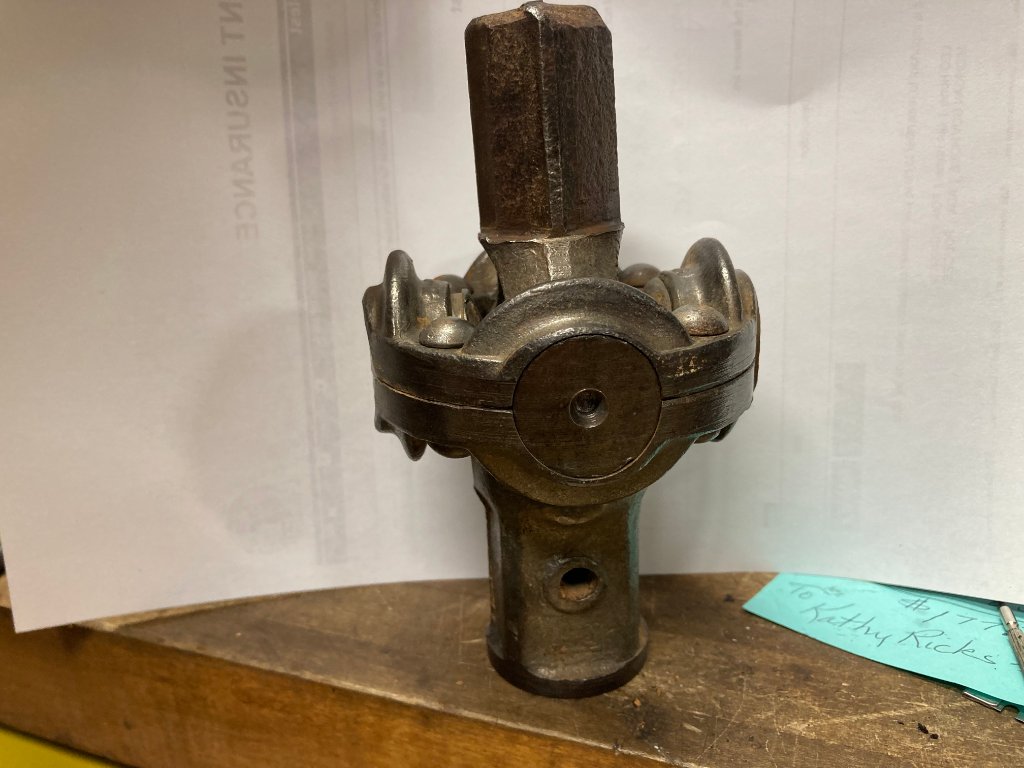

Here's the used U-joint I have

The old one appears to be very nice, as long as the rivets are tight.

Thats a keeper. Throw away the new one and use the Ford u-joint.
