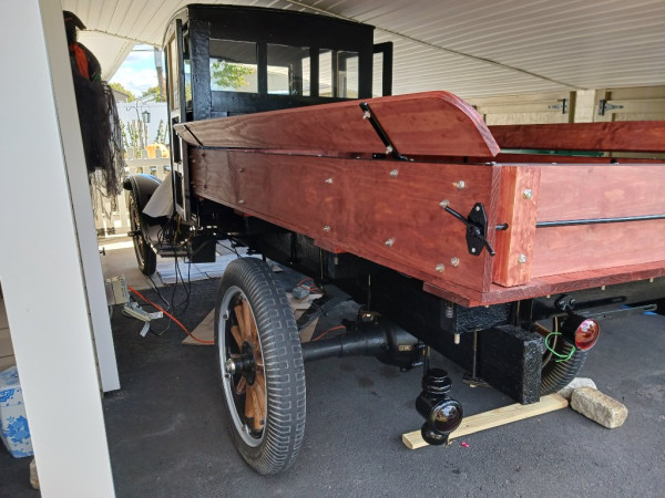

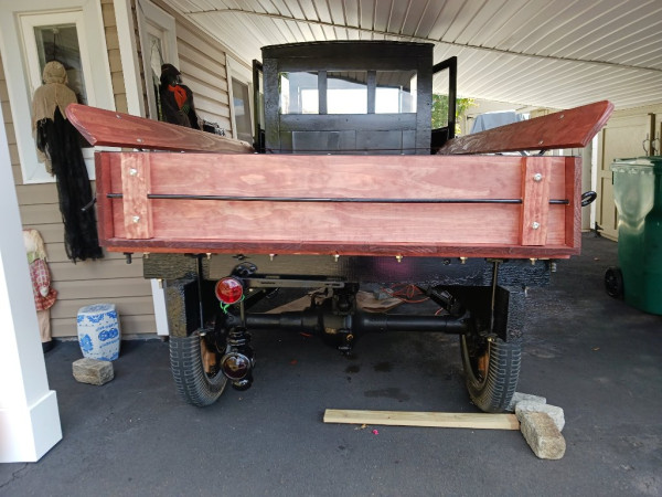

Post by TheSaintDiscJockey » Sat Apr 08, 2023 9:20 am
Just able to squeeze this guy under my carport.

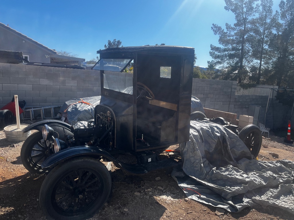

Re: 1926 Model TT Height
Post by Jacob Mangold » Sat Apr 08, 2023 6:41 pm
My ‘24 TT is just above 7 feet tall. Probably 7 foot 1 inch. Mine is a standard cab, not a c cab. They are pretty darn tall. :lol:
