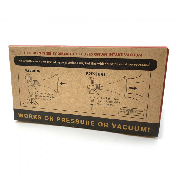

Post by Erik Johnson » Fri Apr 14, 2023 3:04 pm
"Modern" wolf whistles may be opereated via a vacuum or via pressure.
It's a matter of which direction the rotor is installed.
Don't know if "vintage" wolf whistles have the above option.
