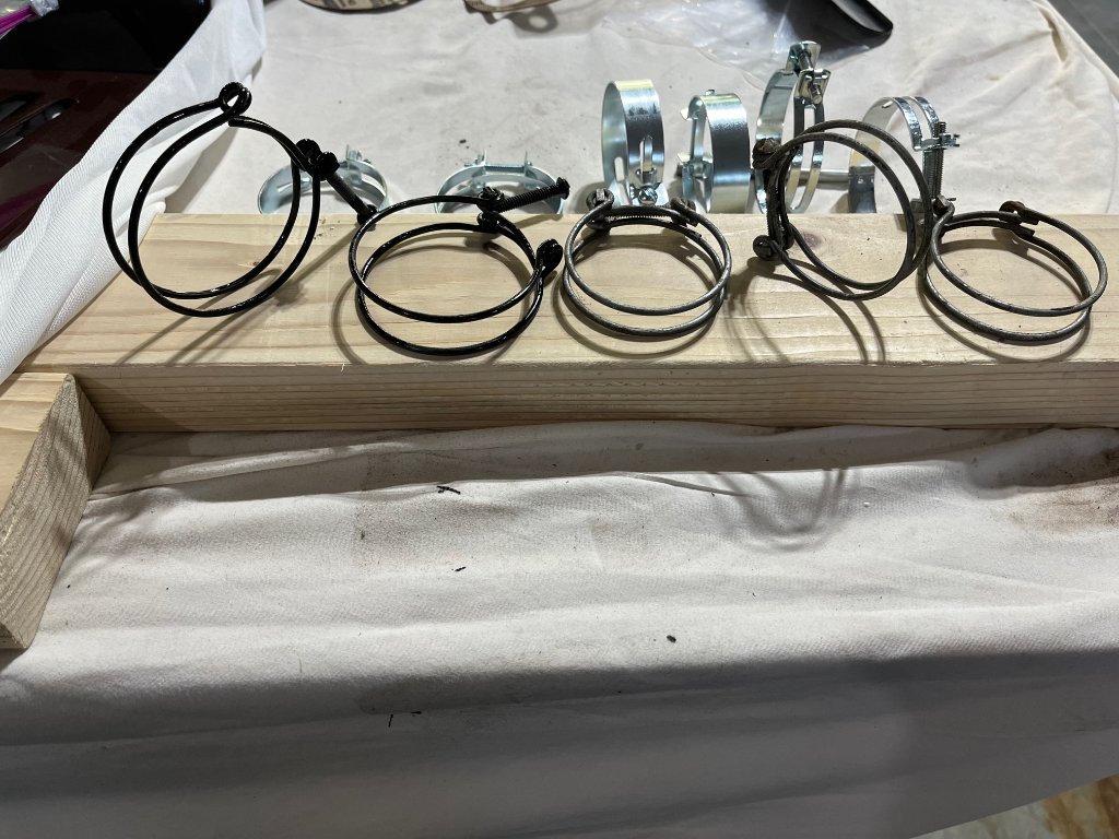

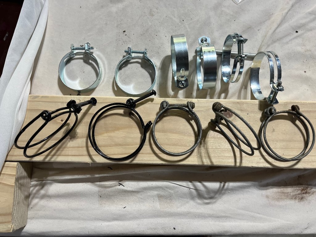

The photos show my old hose clamps and the new ones. Which ones should I use?

Re: Water Hose Clamps
Use the new ones.
Aren't the wire ones Mopar? Anyway, I use the other type that are closer to Ford originals. But I replace the round head screws with fillister heads.
I would use the new ones after running the car for a month or two with modern eorm drive clamps. These will bed the hose in on the castings, and the original style ones will hold that setting.
If you use the original ones initially there is a chance they will not seal and the problem is exacerbated by adding tension. This will distort the ears on the clamps and possibly pinch the hose up between the ends of the clamp , making a leak more pronounced.

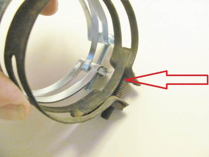

That's exactly so Allan. The repro clamps are much lighter gauge metal than the old ones. One thing about the round head screws - your screwdriver will probably strip the slot before they get tight enough to deform the clamp !
Steve is right, the old ones always had filister head screws !

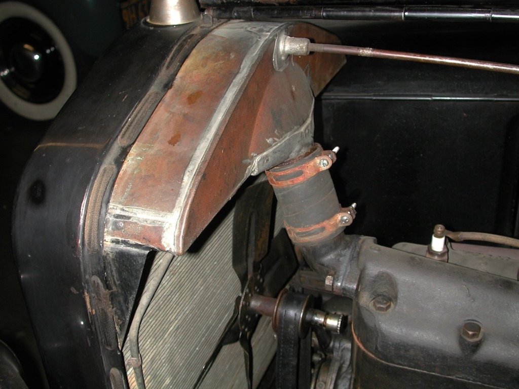

The wire clamps are not original Ford parts.

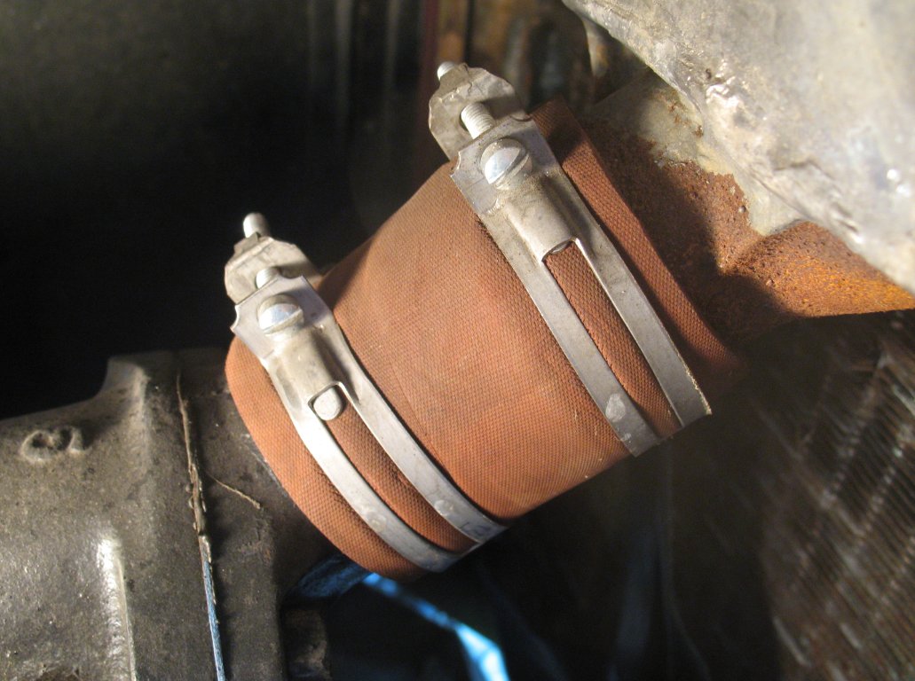

These are the clamps on the 1917 Rip Van Winkle car. It looks like the screws may be new.

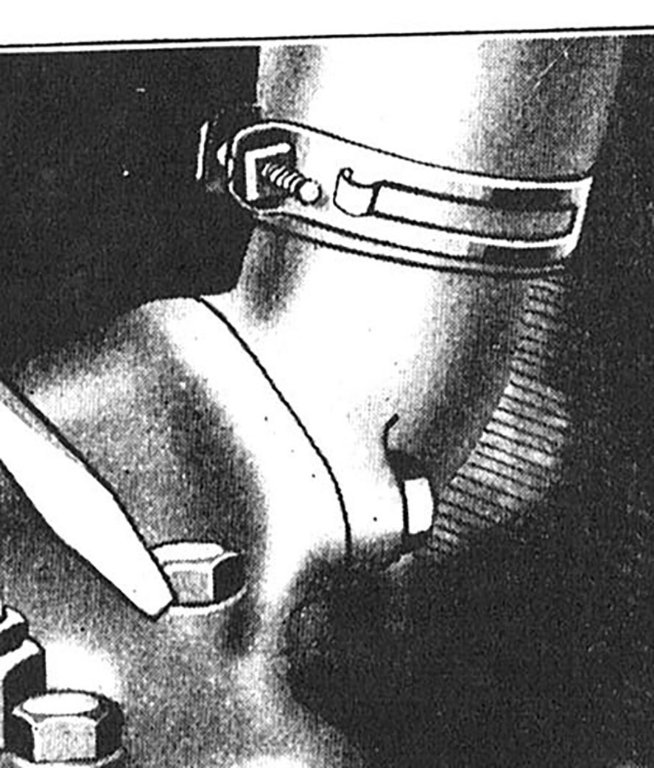

This is what the service manual (Bible) shows. It's good enough for me.
Rich, yup ! That's the critter ! I think Larry means the reproduction clamps are not correct and he is right. Besides being too light for service, the split and the "tail" are wrong and of course, no filister screw.
A few years back I found some clamps of the old type, right groove, right screws, heavily zinc plated ! I thought I'd cut a fat hog, but come to find out, they were slightly smaller in diameter and would not work.

The main difference of the repro hose clamps and the Ford T clamp is in the 'finger' slide that compresses the clamp on the hose.
The Ford design is heavier gauge metal and has robust and wide finger, and its fold over is contained on a larger part of the full clamp body. Provide best grip and compression. The repro clamp has weak narrow finger and fold over is minimal.
