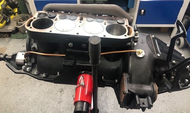

I got a complete rebuild motor. I put the motor in a teststand to run the motor to see that the motor is running fine. After about 10 minutes run (motor is running fine), i removed the sparkplugs. The sparkplug from the first cylinder was complete black with a oil film. The others are fine. So i removed the head and i found this:
2019-05-13 11_10_24-IMG_1632.jpg (32.95 KiB) Viewed 5801 times

Charlie B in N.J.

Is there an outside oil line over feeding #1 ?

Post by Markus » Mon May 13, 2019 7:19 am
Yes, there is an outside oil line.
