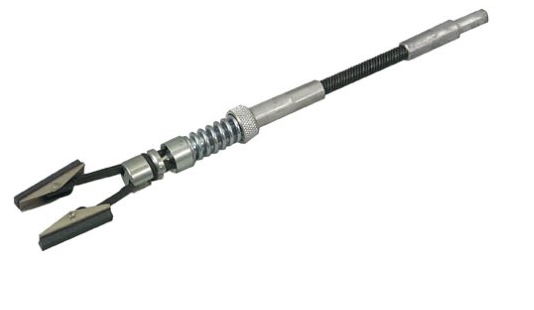

Bill C, Could a brake cylinder hone be used in this application? Much cheaper for a one time use.

I have always used a reamer, It's muck quicker and more acurate. The hone shown would work as long as you only need to remove a small amount of material, go with slow RPM to keep it round and stroke it in and out to keep it straight. Use ATF as a cutting oil and It will flush away the removed material, keep the honing stones wet. Check It often so you don't get too big. Clean it very well to remove any small pieces of grit from the stones or It will ware on the drive shaft. Bill
