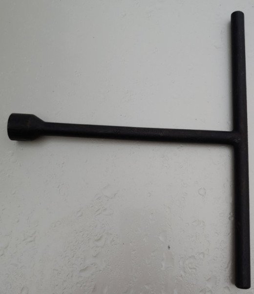

The original wrench for that was a "T" handle wrench and in my mind's-eye, I'd say the handle was about12" long, so the "torque" would be a good strong two-handed twist on that (which if measured with a torque wrench would not be a huge amount).
There were no torque ratings for anything on a "T" and wrench length was the limiting factor that an average man could put into it...so there was a wide range of "acceptable". Axle and perch nuts had very long-handled wrenches and differential bolts had wrenches that were barely longer than a man's palm was wide.
Photo Courtesy of Brian Dowell
