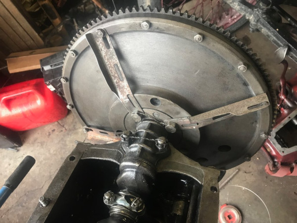

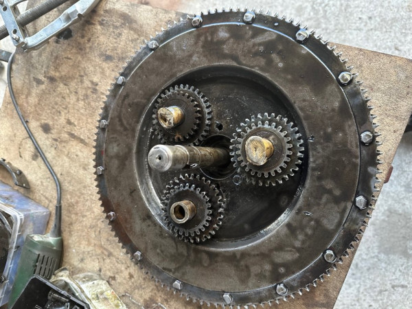

Last week, I overhauled my transmission.
Engine back in place, I started it few times, drove maximum 20 miles but rapidly had difficulties to maneuver in reverse.
Bad sounds, and eventually engine stalling.
I had to dismount again the transmission.
And then, horror show !!!

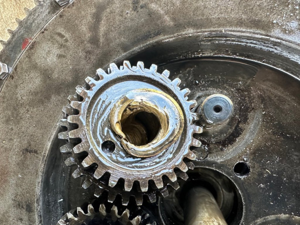

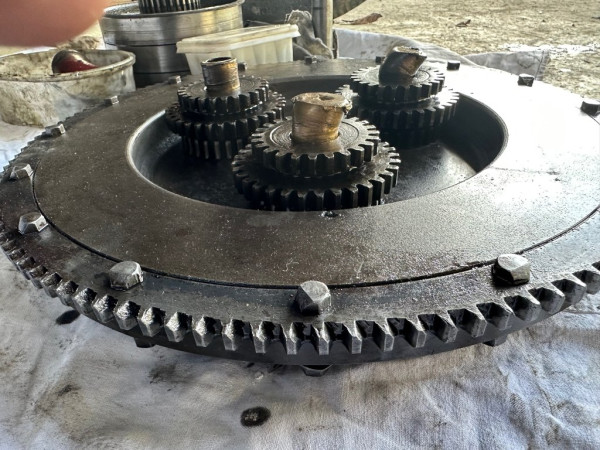

After reading the forum, the adjustment must have been too tight (.002).
But how do you explain the bushing coming out ?
The bushings melted and flowed ?

The bushings were turning in the triple gears is my guess. Maybe the bushings were too tight? Never seen one like that before. There is a tendency to get all the tolerances good and “snug” when we rebuild a T.

I’d suggest that you revisit where you got the bushings? My hunch is that what you show is someone’s homemade mix? You see…the tin apparently melted…yet what stayed behind was bright yellow??? ( which also might suggest ‘other’ brass as the remaining copper should have a pink cast to it.) Smelting bronze is not for the feint of heart and not like baking a cake. It is not just piling up on shavings of the individual components and tossing all in a super hot furnace. There is a trick as when and how to add the ingredients…and also a finite time in seconds to kill the smelt. 🧐
Tin alone will melt at about 230C. Copper will melt at about 1100C. The alloy ‘might not’ melt out until close to the highest temp component. I suspect you had clumps of tin and veins of tin in your bushes??? (Not supposed to be)
As to the 002…sorry you never got the notice! That is way too tight and the life of the rebuild is measured in minutes and hours when set that close. As others point out, 0035 has been deemed to be about the minimum that works even for someone skilled with the tools.
IF what melted out was tin…that happens about 230C (450F) so is plausible if there was no place for oil to go. But it would have to be free tin and not tin atomically locked to copper as alloy.

When I look at that, I do not see bronze; I see something else but don't know what it is, that's for sure. It didn't melt so much as it flowed under heat and pressure. You're looking at 1900F to melt bronze, and you cannot convince me that those parts got that hot - in fact, I'd say it was impossible.
Try to imagine a scenario where metal is 1900F and the oil remains liquid and does not flash into combustion leaving black sooty char everywhere...things sure got hot, but not 1900F hot...what a mess!

I'm going to say it is likely two issues. Bushing clearance was set to tight AND tripple gears were not properly aligned with the drum gears when reinstalled. The slight binding of the gears put a substantial strain on the bushings which caused the gross deformation under low speed engagement.

Pierre did you replace the pins that the triple gears go on? What I’m trying to wrap my mind around is the shoulders had to be twisted off for the bushing to walk up off the pins and out of the triple gears. I’m not sure how that happens. To Scott C.’s remarks on the temp. I agree if it got that hot to melt the brass/bronze coupled with oils & some gas residue there would have been a fire, the temps on motor oils flashpoint is around 420F mixed with a little gas residue I’d guess it’d be even lower. I asked about pin replacement because the only thing I can think of that would cause that calamity is a combination of too little tolerance, loose pins or pins driven in with an angle. I guess it pins were not replaced they were probably worn so much that the triple gear could rock & bind multiple times with the rotation of the engine at speed. I’d also check reverse drum especially for cracks might not be a bad idea to check them all. I could also see that the transmission being dramatically out of alignment that it would create a lot of stress on the triple gears & drums rotating in an elliptical pattern. A real mystery with not enough info so according to William of Ockham the simplest answer with the fewest variables most likely is the correct one.
Fully agree. But how the bushings became what they are ? The answer must be "flow under pressure". There was no smell of hot oil, or hot material.

Pierre did you replace the pins that the triple gears go on? What I’m trying to wrap my mind around is the shoulders had to be twisted off for the bushing to walk up off the pins and out of the triple gears. ...
The pins were not replaced. They looked in good shape. Solidely attached to the flywheel. No play at all. And they are still firmly in place after this mess !!
How do you check the angle ? With a small simple machinist square ?
The shoulders have not been twisted off (you see it on the first picture). And the bushing did not walk up off the pins and out of the triple gears.
It just flowed !!

The triple gear pins have to be perfect to fit the new bushings , If there is any wear as they always wear on one side.
They need to be replaced from just overheating them alone.

From an examination of the photos posted, I’m concluding this is a likely scenario:
The pins were pressed too far thru the flywheel.
The flanges grabbed and galled at the area of the pin that was too wide.
The bushings then spun in the gears and the flanges broke off.
What looks like “melted ends” sticking out of the gears is where the ends of the bushings bent & smeared when they worked far enough out to contact the reverse drum.
It is quite likely that the first three things happened and there was nothing noticeably wrong until the spun bushings worked far enough back to hit the reverse drum.
Another thing I noticed is that it looks like your flywheel may be an earlier non-starter flywheel that was machined to accept a ring gear. If there is a combination of early and late parts in this trans, perhaps there are also potential issues with incorrect combinations of disc-drum, brake drum, and clutch plate spacers you are contending with as well.

Okay... It doesn’t mean the last guy that replaced triple gear pins did it right. Look at the picture…
Unless the picture is showing a really exaggerated view of what is actually there, that pin is pressed too far thru the flywheel and there is a definite shoulder exposed to the bushing…
Also, by the surface finish on the end of that triple gear pin, it isn’t a FORD pin. There was a small run of Substandard TG pins that were an issue a couple years ago, as well as a larger issue about 30 years ago.
AND, it’s a non-standard, aftermarket, specialty flywheel with no counterbore on the back side to help the average mechanic properly set pin depths…

I would not trust those oil slingers not to fatigue and break in service.

Pat is correct, those slingers are way too light.
No counterbore on the backside, you mean a way to press the pin flush ?
You idea is that the diameter of 0.681" which is pressed in the flywheels is exposed to the bushing. I don't think so, but I will check the diameter/length of the pin when I will take them off. They have certainly not been replaced a couple years ago. But 30 years ago, who knows ???
They look quite robust as they are still in place after this mess. I would really think if something was poor quality, it was the bushing.
The flanges of the bushings did not brake. That's why I said the bushings flew. I cannot take them off.
What you see of the picture is the rest of the flange at the back of the TG.

OK, I will change them.....or put a standard flywheel with slingers from the vendors.

The sheet metal slingers offered in the past were prone to failure. Cracks & breaking.
I dont know if the current offering has improved.
Personally, I make my own from 1" X 1/8" 90 degree extruded aluminum T6.

Dan McEachern manufactures a good oil slinger set !

The oil slingers shown are too thin and will break. I have seen a setup like what you show last for about 20 minutes before breaking. Also they are not needed, The teeth on the flywheel ring sear will move lots of oil. I have a Scat crankshaft in my car with no slingers and have run it hard for many miles without any problems.
What is important is getting the proper oil grooves and dippers added to the rod bearings.
