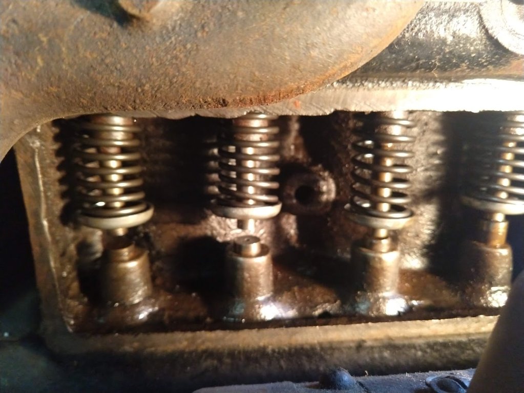

I love borescopes, but you don't need one to see a valve...a flashlight and eyeball looking through the spark plug hole is all you need.
regarding valve movement, the easiest thing to do to watch while cranking engine over is to pull the valve covers off. On your "dead" cylinder you'll probably find one valve stuck full open and if so, you can put a couple pennies on top of the push rod/lifter and "overlift" the stuck valve and with oil, eventually get it moving again.
After you've squirted oil into the cylinders to get wet compression, focus a lot of penetrating oil onto/into the valve guides from the sparkplug hole and let everything sit 'til next weekend.

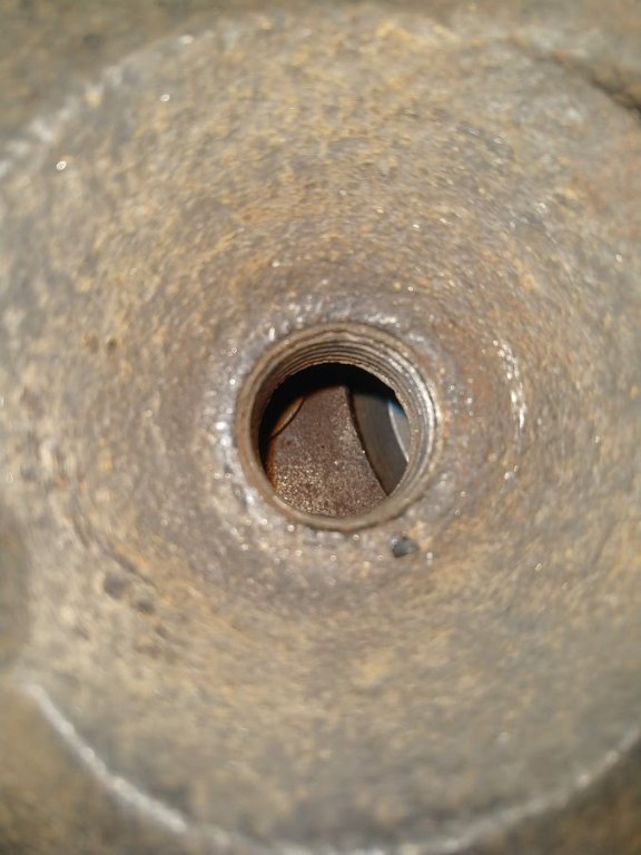

Here is a shot of the number 1 cylinder. The others are similar. It looks pretty clean. Can you tell anything from looking at it?
Tomorrow I'll try a compression test with some Kroil that I shot into each cylinder, and also see if I can see a valve that is stuck.

Kroil is going to be good to free up valves, but it isn't going to seal the rings like a shot of motor oil will, so for your compression check, plan on motor oil...
orient the pistons 1/2 way down the cylinders and give a few really liberal shots of motor oil DOWN THE CYLINDER on all four, and wait a minute...now you can do compression tests again and see if any come up (some will). That will be the wet test to compare to the dry test.

To add to Scott’s reminder on oil, don’t forget to have the throttle wide open and all the spark plugs out so you get a more robust spin to test each cylinder.

Yesterday I took off the two valve covers and discovered why cylinder #2 had no compression. Both valves were stuck open. See photo. I believe the engine was rebuilt (all looks new and clean) but I noticed a tiny speck of rust inside the cylinder. I put a bunch of Kroil in each cylinder and got one of the valves moving, but the exhaust of #2 wouldn't budge. Reluctantly I tapped the valve from above and got it to move, but it kept hanging up until I work it for about an hour. Now all valves are moving. Valves look bent, but that's only the perspective of the lens.
There are no nuts to adjust these valves; and I got readings of about .025. Is this OK?
Other things: I raised one wheel and still it's hard to hand crank. Should I raise both wheels? I think so.
Battery looks dead (on a charger over a day or two. Oil in engine looks clean; so I'm thinking the engine was never run, but just sat for a couple of years. I took the starter out to replace brushes, so that will work better. Cables are all new from vendors. I will clean contacts to make sure power gets through.
Is it possible to get a better free neutral that will allow engine to crank over better? I've not looked into the differential to see what its condition is.
Thanks all for your support.
John

Since this is a total unknown to you, I'd be inclined to jack up the rear and block front wheels...put transmission into neutral (but not with brakes) and allow the rear wheels to become a flywheel for you. This will reduce strain on starter and aid in getting the car started since the natural drag in the transmission will be relieved by transmitting that reluctance to the (rotating) wheels.
I'd also flood the valves through the plug holes as I mentioned earlier and now that you have the covers off, I'd flood the stems, too. You can also lift those valves more, to break stiction in the guides and give the Kroil a path in.

Thanks Scott. I'll do that with the oil, and jack up the other rear wheel. Also want to try to get a free neutral. Have to research that.
John
