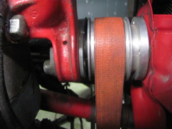

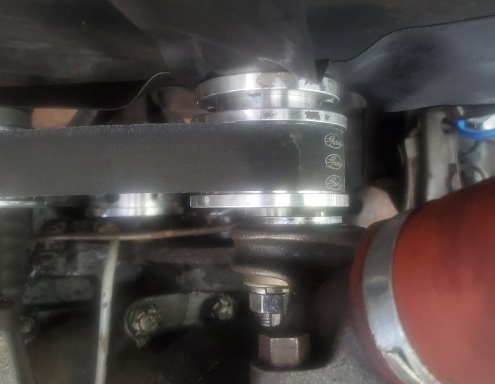

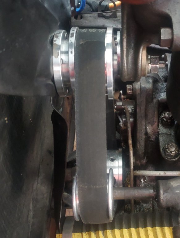

It is the 26 inlet/fan pulley mount. There is a washer between the eccentric mount and the pulley but that's to give it clearance for the pin that holds the eccentric mount and plate together.
I've attached a photo from each side. One I tried to line the lens up with the crank pulley and the other to show the back side of the fan pulley.
Thanks for all the help

If you loosen and pull/push your waterpump pulley "back" about 3/8" or so, I'll bet that all will be good.
Looking at the picture a second time, it looks like the waterpump pully has already walked forward 1/2" or so which further leads me to believe I'm correct on your fix. The belt is clearly crowded forward by it and is the one thing that is almost infinitely adjustable.

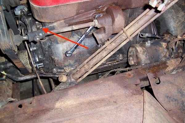

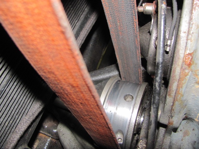

John...no, the pully lines up as original...it's just that there is an additional "snoot" on the pully (about 1.5" long) which pushes the fan "out" toward the radiator. It is all hollow and the original fan bolt works with it like it was a normal "short" one. With respect to the OP, his pulley is a ball bearing new pulley and I agree that it appears a little "forward", but given their distance apart and the fact that they both have heavy lips on them (and the fact that the waterpump pulley is crowding and deforming the belt, I suspect that any minimal fan/crank misalignment will offer negligible inputs relative to the waterpump's apparent significant misalignment
Photo credit: Ron Patterson

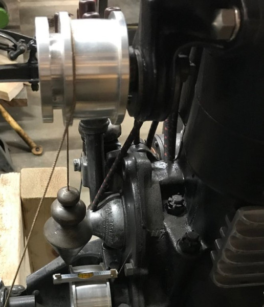

Calvin what Gates belt are you using?

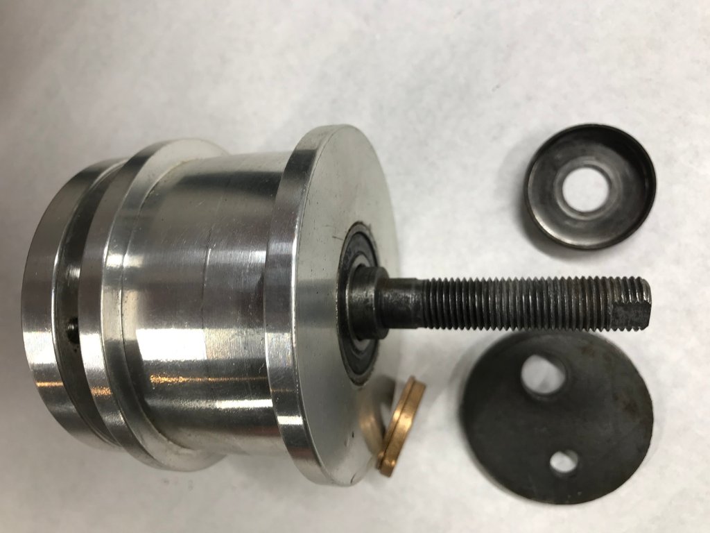

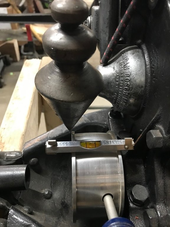

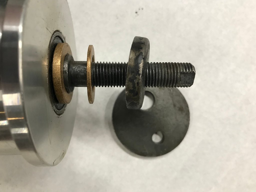

Took some pictures of my set-up with the sealed bearing pulley. The race of the bearings wasn't a tight fit so I needed to place the felt with some washers, found two that fit perfect and when bolted tight held everything in place.
Took some pictures with a plumb-bob to show alignment. Engine is slightly off level else the plum-bob would be right on. Not sure what washers are being refereed to in the above picture of Calvin's pulley. The shinny portion is the part of the concentric setup and what looks like the cap that goes over the felt.
Note the plumb-bob string is on the opposite side of the pulley and on the inside of he pulley lip. Photo makes it look different
after all this I found that my belt is too short :oops:

That is not at all out of alignment to the extent that it will throw a belt. The good news is that you can move it "back" if you wish, by simply shifting a washer or two to under the bolt head in front, rather than at the back. Also, you can get rid of the "cap" and the extra washer...
I run one of those pulleys on one of my Ts and recall having to do the same thing with shims...

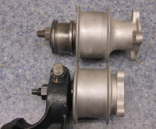

Thanks Scott for the pictures of the 26/7 fan pulley didn’t realize that it was the casting that changed the position. Learn something new every day.
