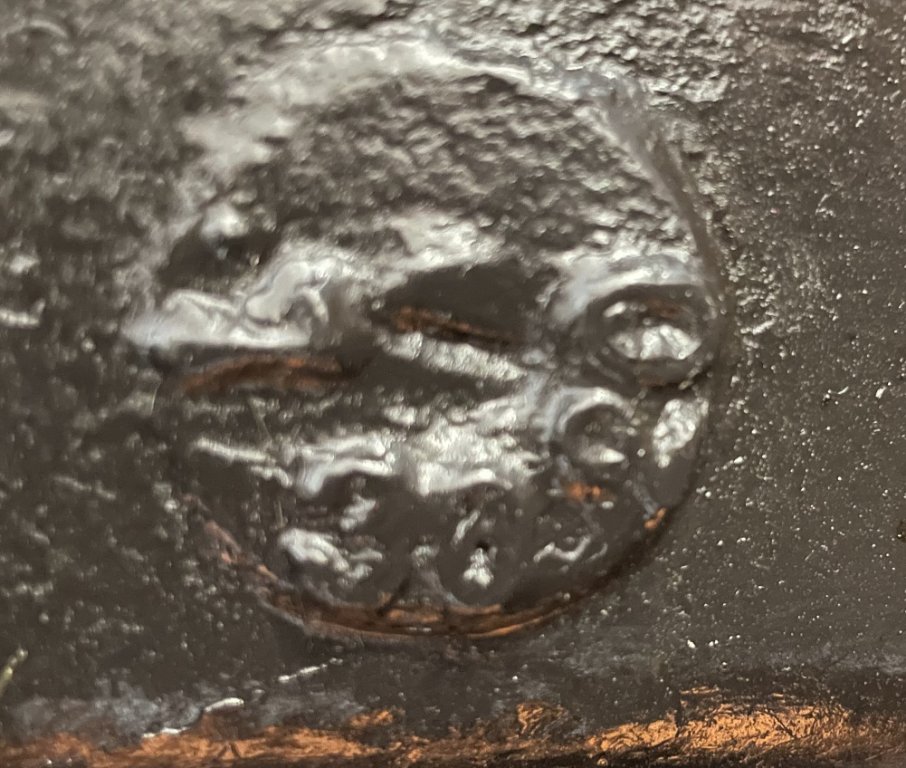

Post by DaveBarker » Thu Apr 27, 2023 10:10 am
Not sure of the details on when they ceased casting dates, but mine looks like it has the casting date as 1/30/1920.

Re: Engine casting date
Post by richc » Thu Apr 27, 2023 10:16 am
Casting dates disappeared in early 1922 for US production. Most people figure that when the change from two piece valve covers to the one piece cover, which occurred from late 1921 into early 1922, that with the change in the casting mold at that time was also when the casting date was dropped. However, I have a 1922 one piece valve cover block which has a casting date 3-13-22.
The Canadian engine blocks had casting dates throughout production.
