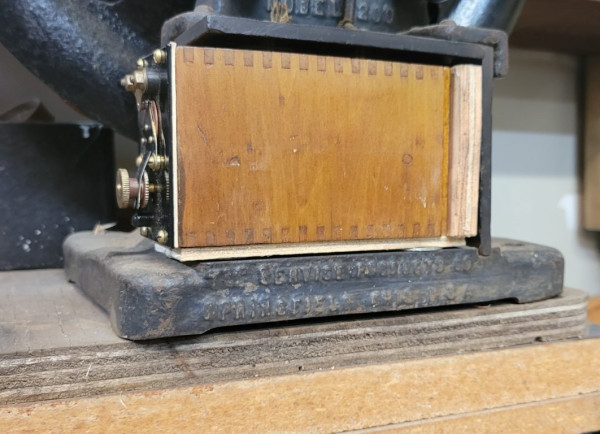

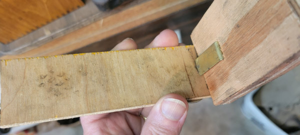

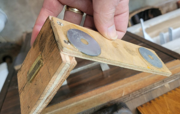

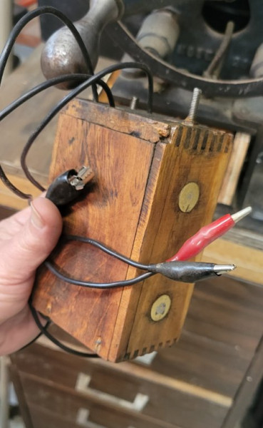

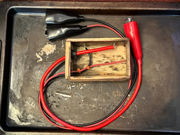

MKossor
- Posts: 549
- Joined: Sun Jan 06, 2019 7:30 pm
- First Name: Mike
- Last Name: Kossor
- Location: Kenilworth, NJ 07033
Re: Old Style Coils VS New Style Coils
Here is more information on Heinze coils and Heinze coil tuning :
https://mtfca.com/phpBB3/viewtopic.php?f=2&t=26730
Could be the capacitor is bad or the wrong value. An adapter can be made to test Heinze coils using the ECCT but the test limits will be different. That's why the reason the Heinze Edition ECCT was made. Engine performance reported by Heinze coils users tuned on the ECCT have been excellent. The Heinze coil is really an excellent design.
Unfortunately, Henze coils Cannot be properly adjusted on the HCCT by measuring average coil Current, they will almost always exhibit double sparking. Attempts to prevent double sparking will assure improper adjustment. Heinze coils MUST tuned for equal dwell time to fire spark by actually measuring dwell time to fire spark.

I made this remote coil adapter for my HCCT.
Now I can make any form of coil fixture and connect to the coil.
I then use the HCCT to test and adjust the parameters of the coil.

Bob, I made one if those, too!
I also made an adapter for Heinze coils for the HCCT.
Keith
