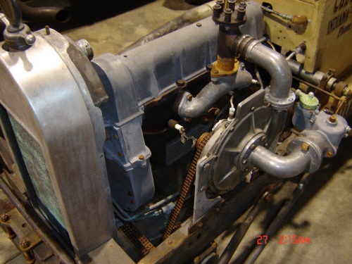

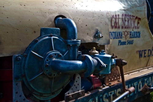

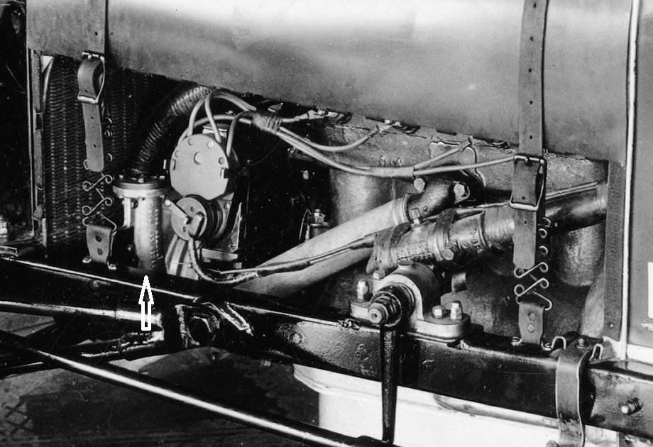

The Supercharged McCathren Special Model T Ford Racing Car
https://www.mtfca.com/discus/messages/3 ... 1384545629

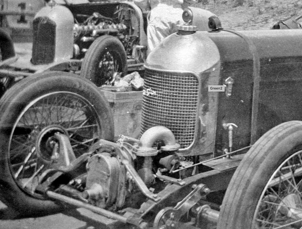

Re: Kazuma T
Nothing wrong with era correct superchargers…
http://buymegivemetakeme.com/fronty%20sprint/index.htm

My dad used to run around with Les Stilwell, Bob's dad or uncle. Earl McCatheren ran the Dodge dealeship in Breckenridge Tx into the 1970s.

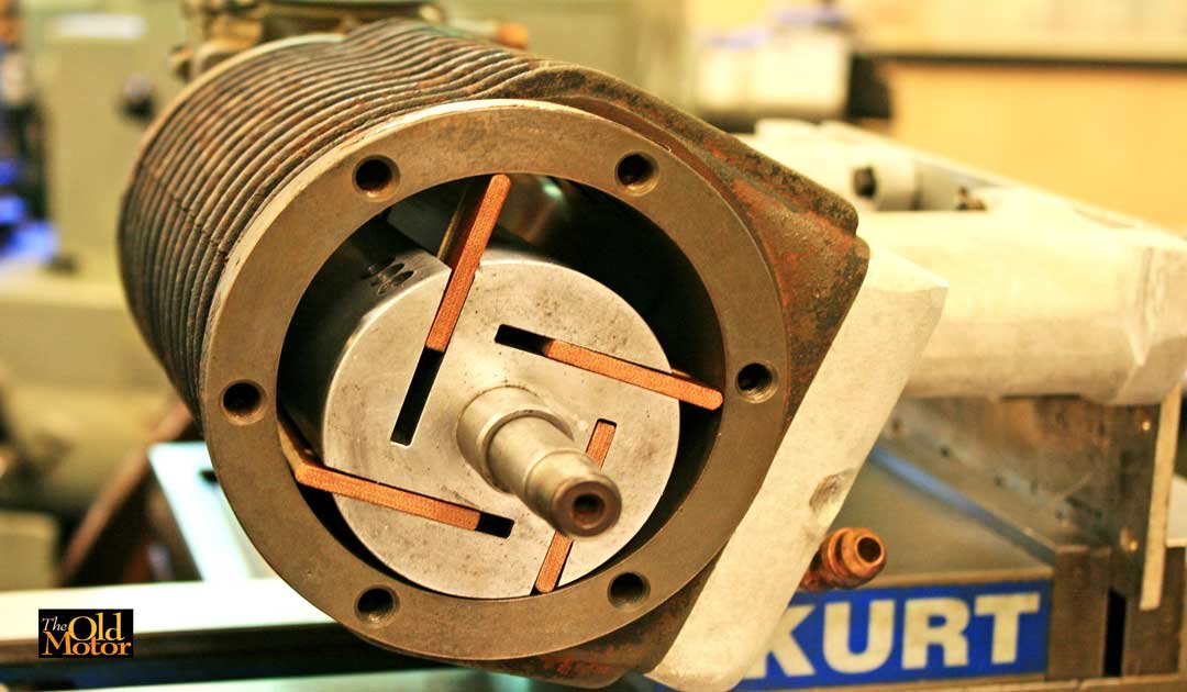

Never on a T but back in the sunny days of my mis-begotten youth I installed a Judson supercharger on a friend's Austin Healey Sprite. Really brought that little booger to life. The most fun came with the "stop light grand prix." If the Sprite sat idling for a minute or two a few drops of Marvel Mystery oil from the supercharger's Alemite lubricator would accumulate somewhere. When the MBG, TR-3, TR-4 or Sunbeam Alpine in the other lane who was planning on trouncing that miserable little Sprite would be left in a cloud of MMO smoke. Lots of fun back then. Bob

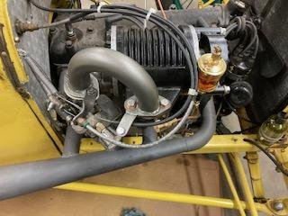

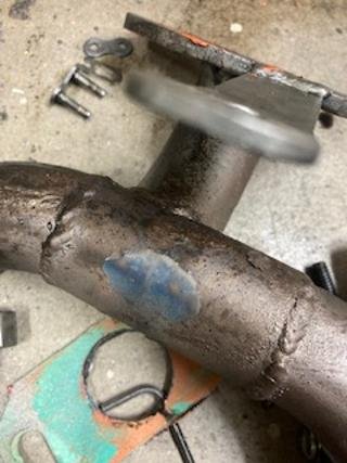

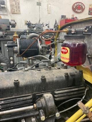

Hi Pat,
Yes I have tried it with mixed results. The performance was OK even though it only produced 2-3 lbs of boost. The car developed overheating
issues so I removed it (still had some Temp. issues ) The boost dropped off at 1600-1700 RPM Judsons loose efficancy at high RPM and to
compensate for the small size I drove it at 3.1:1 using the generator gear. I'm thinking this is to fast as the heat from the Judson burned the
paint of the manifold. There is not much room for a air to air aftercooler on a T. And the manifold is close to the exhaust. I'm thinking next
try I will slow down the Judson & try to shield the intake from the exhaust. And not test it when it's 105 degrees out. The intension was not
so much for speed but for better performance at high elevations 5000' + were T's seem to be anemic when it comes to steep hills.
Craig.

I'd guess that 2-3 lbs of boost is all the engine would stand, and you probably would want to taper off the boost as you approached 2000 RPM. I wouldn't think you'd have enough pressure to cause the intake to get very hot. Some way of getting cool air to the supercharger intake would help performance and help keep the heat down. An expansion chamber might help with intercooling. A manual wastegate control with a dash mounted boost gauge might be helpful. It looks like a sizeable can of worms for a street car. Adding EFI might simplify things.

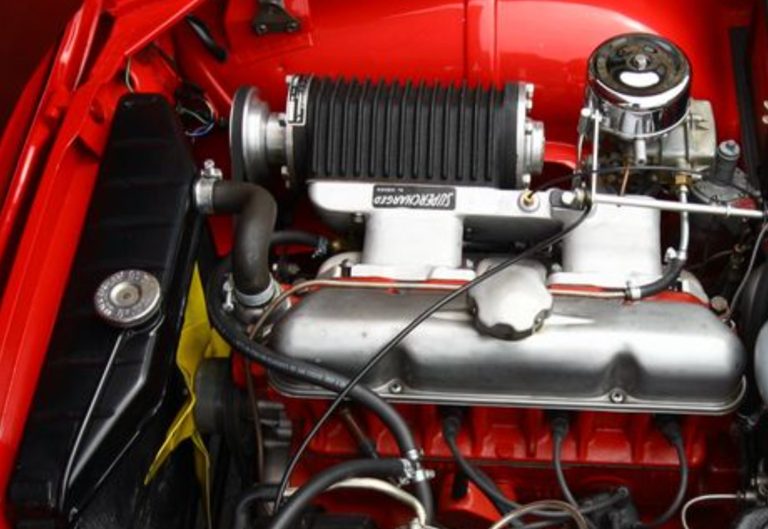

Re: Kazuma T
I have a couple of Judson Volvo B18 superchargers (I vintage race a '67 Volvo 1800S with the VSCCA in New England https://www.youtube.com/watch?v=h6RUeERnkAU ). The Volvo B18 engine is 108 CI, and this size blower (the largest) was also used on MG, Triumph, Mercedes 190, and on 139 and the 163 CI Corvair engines and the larger engine is close to the size to a T 177 CI engine. A Judson can be run at 5000 RPM.TXGOAT2 wrote: ↑Sat Apr 29, 2023 2:52 pmI'd guess that 2-3 lbs of boost is all the engine would stand, and you probably would want to taper off the boost as you approached 2000 RPM. I wouldn't think you'd have enough pressure to cause the intake to get very hot. Some way of getting cool air to the supercharger intake would help performance and help keep the heat down. An expansion chamber might help with intercooling. A manual wastegate control with a dash mounted boost gauge might be helpful. It looks like a sizeable can of worms for a street car. Adding EFI might simplify things.
Aluminum Judson rotor with Micarta vanes that is a composite of canvas, or other fabric in a thermosetting plastic. The vanes lubricated and cooled by a Marvel Mystery oiler and the air and gasoline mixture.
I also have an original T racing car with a SR Fronty racing engine with a counter-balanced crankshaft with 1.625" main and rod journals and quite a bit of engine set back and room for a crank-driven blower. Have thought it would be a very interesting project to set up vintage roots type blower or a Judson off of the front of the crankshaft in the same manner as the Green Engineering special powered by Green supercharger in the photo below. Mounting one out in front of the radiator would allow it to be air cooled. Vintage Bentley's were also equipped with a front-mounted blower.

Hi Pat,
The only guy I know that runs EFI on a T has ported out the block & divided the ports to give 4 ports one for each injector. That solves the
1,2,4,3 firing order issue. Wich may be the best part of pressurizing the intake on a T. But it's a lot of work. Maybe GDI would be a better
option? Then there will be a bunch of complaints about having a ECM in a Model T. My thought was that Judson started making rotory vaine
blowers & suerchargers in I think in 1902 that would be somewhat period correct? Speaking of a can of worms wasn't disc brakes pattened
that same year??? But then I degress. You asked so thats were I'm at on this. Henry & Thomas had less than stellar results in their first
attempts. Maybe I will have some success in the future??

What would help you out as you have found is to find a large sized Judson with a 10" long blower housing because as you mention what you are using is too small and sized for a 60 CI Austin Healey or MG Midget engine. A T is 177 CI and running the larger blower it at 1:1 would work better and is about what it is designed for. Drive the blower off of the crank in front of the radiator to keep it cooler. It is likely the timing gears and the small front cam bearing will wear quite quickly because of the much heavier load the supercharger imposes over the small amount of power that a generator requires.Craig Leach wrote: ↑Sat Apr 29, 2023 1:18 pmHi Pat,
If you haven't talked with George Folchi contact him, he maybe able to help with a 10" unit @ http://www.judsonguru.com/ or the Judson Supercharger Society Facebook page they turn up now and then @ https://www.facebook.com/groups/383542915014715
Good luck with what ever you try next.

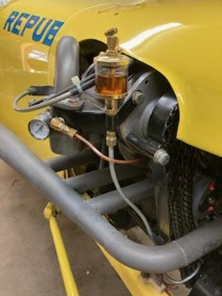

Hi David,
Yes have talked to George several times he is a wealth of Judson info. He set me up with new seals & vaines and lots of info on setting them up
He is very helpful. I traded some parts I didn't need for some I did. He talked like if I gave up on the project he would make me an offer on what
I had. I still would like to persue this as I realy liked the results of what I have got so far. I didn't concider a turbo because of the oiling issue but
have talked to someone that has a electric oil pump solution to lube a turbo.
Craig.
